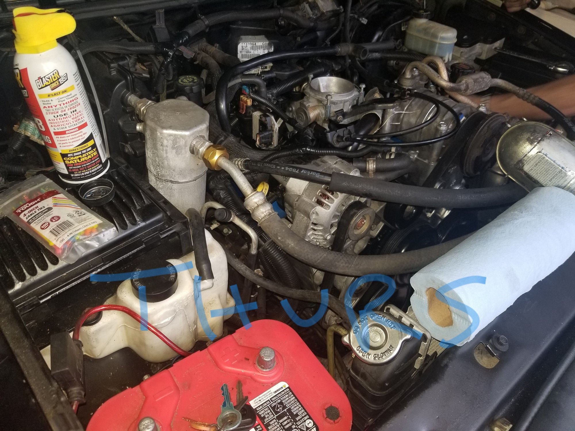

Well we finally cranked her up yesterday..this has been a long drawn out process of learning, making mistakes and finger crossing. 1999 2wd 2dr Blazer.
164k miles. First time I cranked it started right up, no crazy noises or anything. I ran it for about 15 secs. I'm still skiddish.
Looked underneath for any leaks and there was oil everywhere.. upon further investigation it was coming from the cooler line connection. Went to store bought more oil and a gasket kit. Installed new gasket and saw that the gasket still moved a little when tight. Long story short , had a longer bellhousing bolt and cooler line bolt in wrong place. Once finished, cranked it up again and let it run for about 4-5 mins. Just looking,listening and observing. I'm going back this morning to run her down the road. Does anyone have any pointers as to breaking her in right? I know I should take it easy ... As of now,. She's just idling high and have a rattling noise from the exhaust pipe . Have a throttle position sensor code and ftp sensor code. Any advice???
