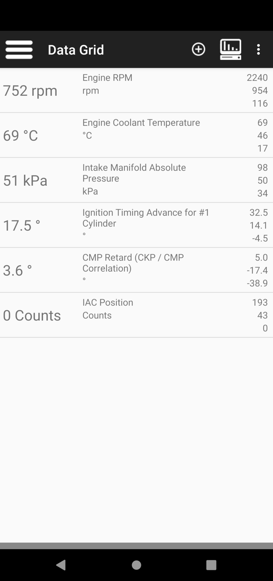

here's the screenshot I could finally get. I've tried to load a video of it running but I can't get it to accept it. From the noise it's making it's got to have an internal engine problem. I wish I could get it where you can listen to it. At least it's running enough now to load onto someone's trailer, or rollback. Haha.

Most of the noise you hear in the video sounds like it's coming from below the intake manifold. Could the balancer shaft be broken? My biggest concern is, that at mid rpm's there is a secondary noise from below. I guess I need to check compression again.
