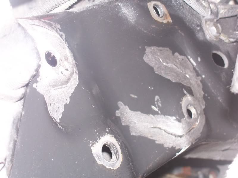

The steering geometry in the square body full size trucks isn't the greatest in terms of feel in factory new condition. A lot has to do with the push-pull drag link setup that is on the 4wd models and not a lot to do with the steering column or steering gearbox itself. Then there is the propensity for the frame to crack under the steering gearbox which adds to the rubbery feeling. But lets get those specifics and go from there.

Ok, assuming it is a 4wd model, I would go through the steering joints checking for play. There are 4 tie rod end joints in the system; two in the drag link between the steering gearbox and the driver side steering knuckle and two in the crossover link that runs between the two steering knuckles. The diagram below is from LMC Truck:
Inspect the frame around the gearbox as well. There are a few different bolt in brace kits that were available last I looked, but it has been awhile. There used to be weld in frame repair/reinforcement panels as well made by ORD --> LINK TO THEIR PAGE. The image below shows some typical cracks that can form. This is taken with the steering gearbox removed, but the cracks can often be seen from the inside of the frame rail.

I had a mechanic replace all of the old Tie rods, knuckles, and all the rest of the front end suspension when I first got her. I asked him to look for any cracked frame while he changed some stuff out and he said he couldn’t see any issues with the frame.

That is good that your frame is crack free. The bolt in support for the steering box area can still be a beneficial addition even for an around town cruiser.
