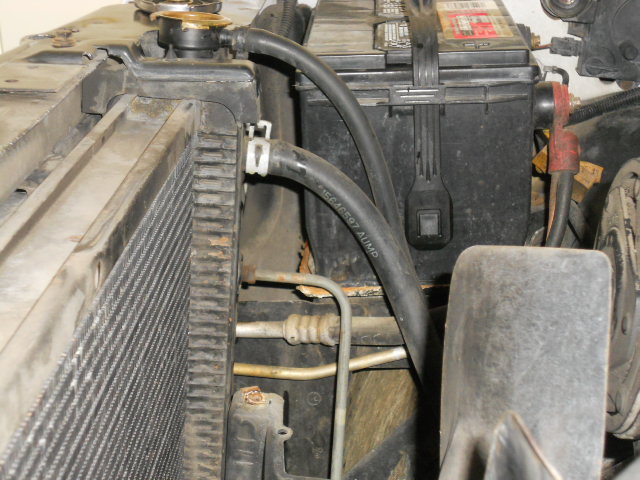

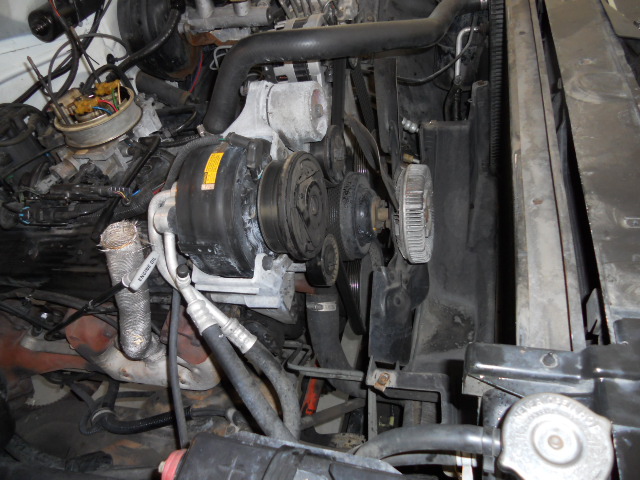

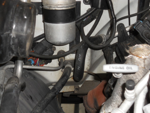

If you can, take some pictures of your engine including any lines to/from the engine that are thought to be coolant lines and post them here.

Ok . Here is a couple of pics . If there's different views you need let me know .Engine runs cold-picture-1214.jpg

Replaced t-stat again . No change . It's about 80 here today and temp will not go above 150 still . Hot air comes out of the heater but upper hose is not hot . This sucks .
