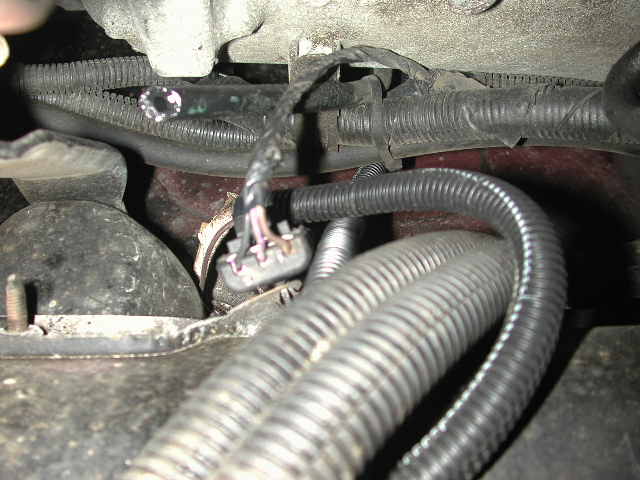

Here's a shot of the old actuator before removal....
The original harness hookup..... You unhook the one on the right. The lower portion goes to the old actuator.
This is the old actuator removed....
I spliced the new brown wire inside to avoid corrosion problems.
I found that the brown wire that comes from the transfer case passes inside through the 4x4 floor shift
console. I loosened the four bolts that hold the mounting plate down and pushed the new wire in along
side the existing wires.
Here's a shot from under the 4x4 floor shifter showing somewhat where the wire goes through..
You can see it tucked under the connector with the brown wire coming out the end.
