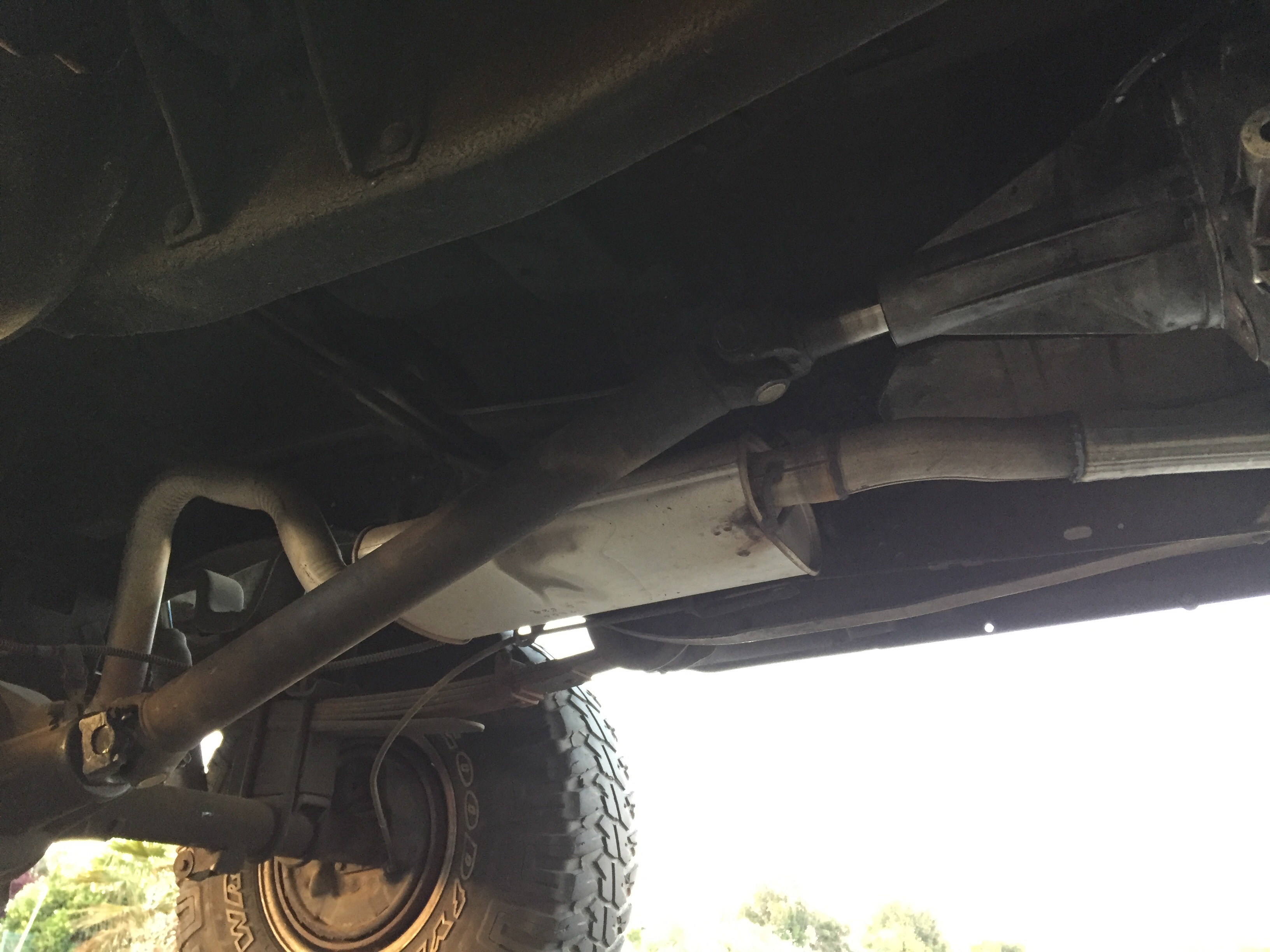

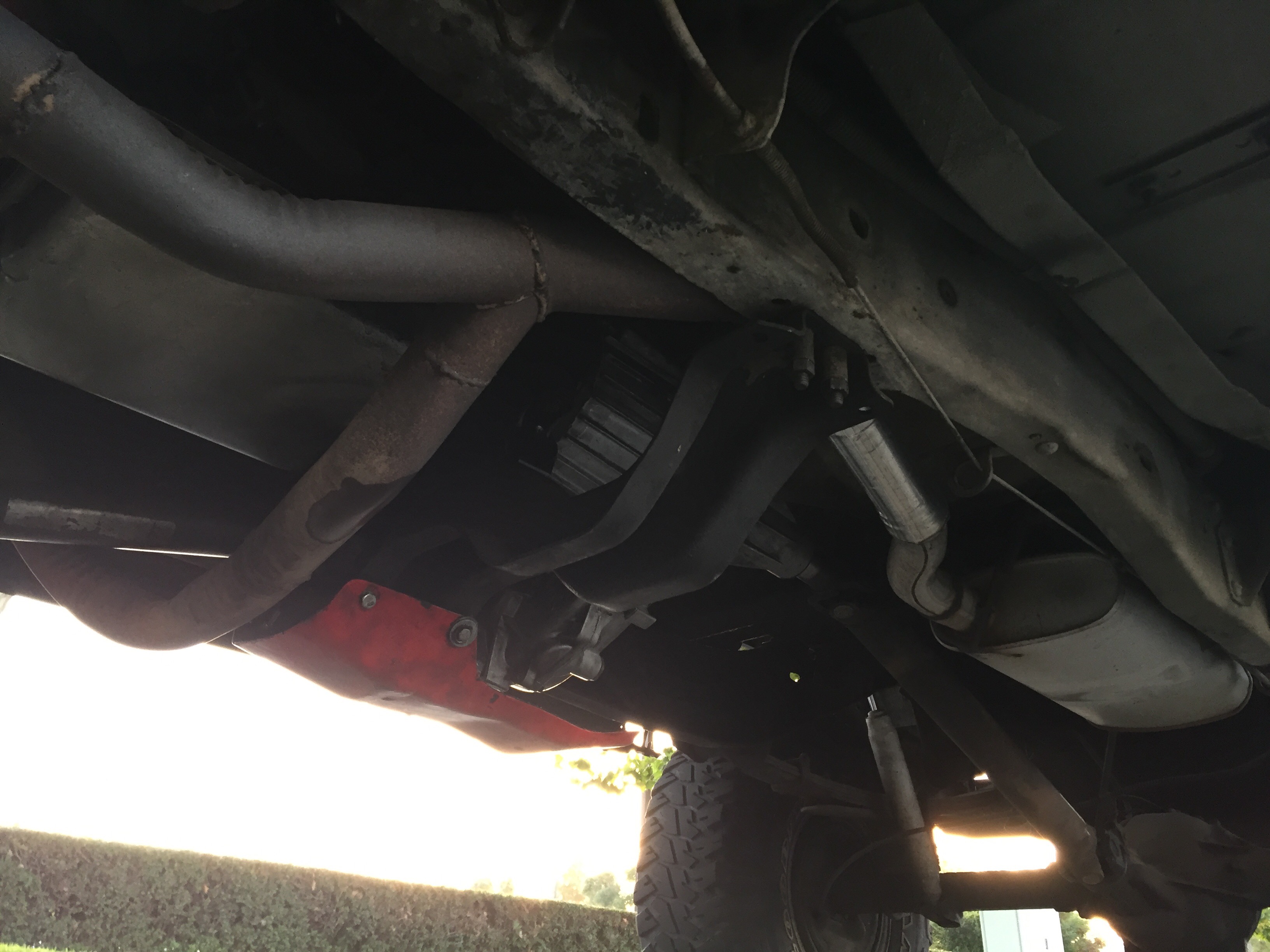

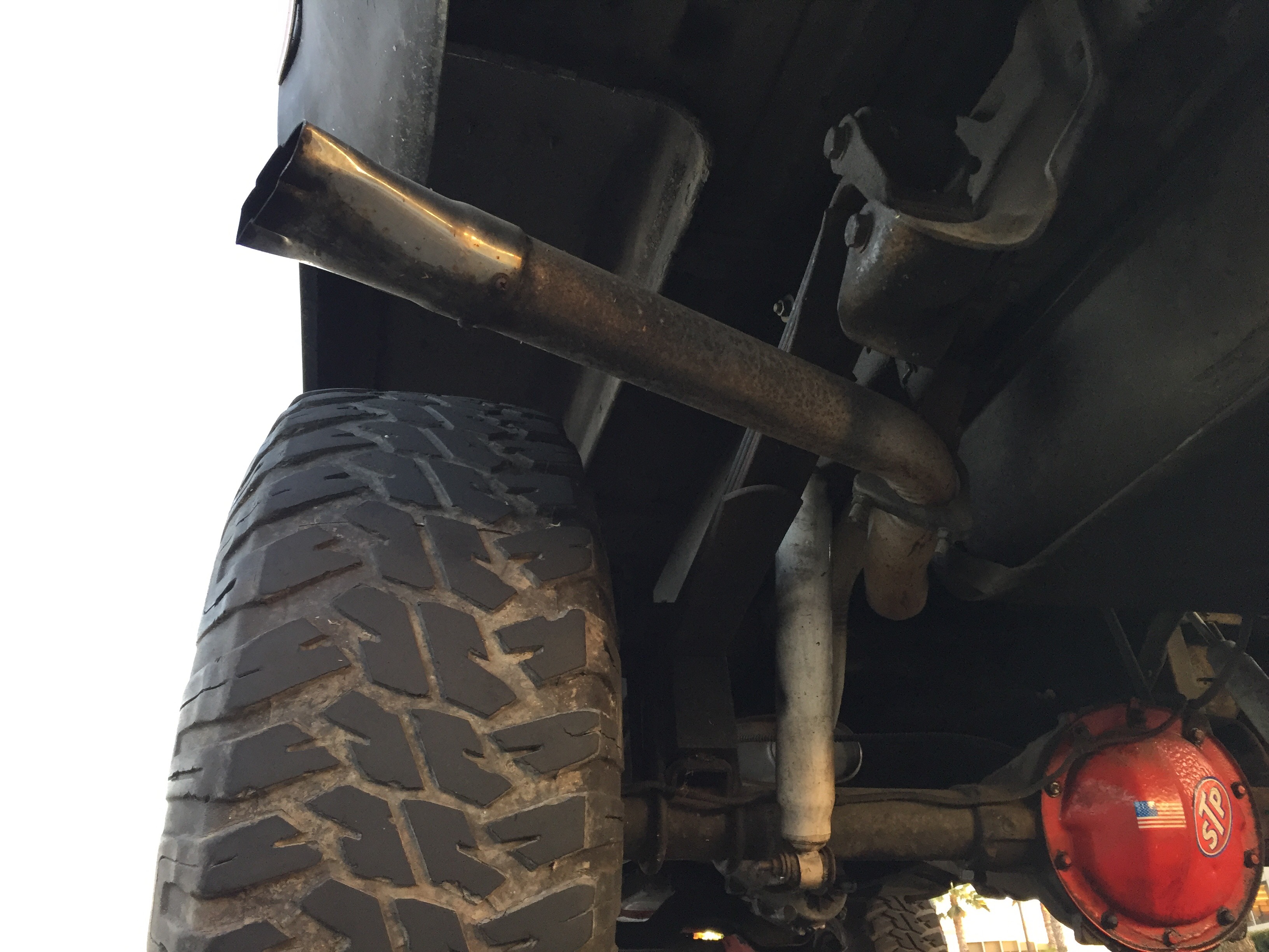

Attaching couple of pictures of the exhaust. Not sure what's standard and what not, I want to figure all that out.
Attached Thumbnails Missing tubes?-img_3319.jpg   Missing tubes?-img_3320.jpg   Missing tubes?-img_3321.jpg   Missing tubes?-img_3322.jpg
Old Sep 5, 2018 | 10:38 PM
Looks like the cat has been removed, just like the rest of the smog equipment. To be honest, if I were you, I would go demand my money back from the seller. Whoever smogged that thing should lose their license.

The more I look at these pictures, the more I see wrong with this truck and the more of a hassle it is going to be for whoever ends up bringing it back into compliance with CA emissions.
As far as your video, it looks like the cross-over pipe has a crack that is leaking exhaust. The faint ticking is a dead giveaway. It likely is rusted out where the two pipes are slid over each other and what you are noticing is moisture boiling out of that joint at the crack. Man that thing idles high!
