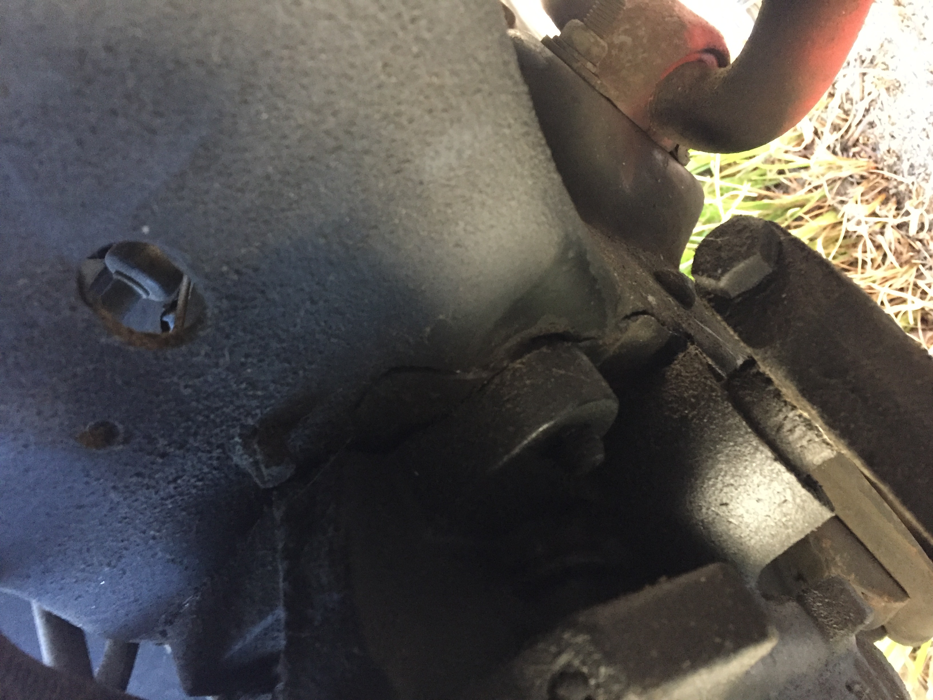

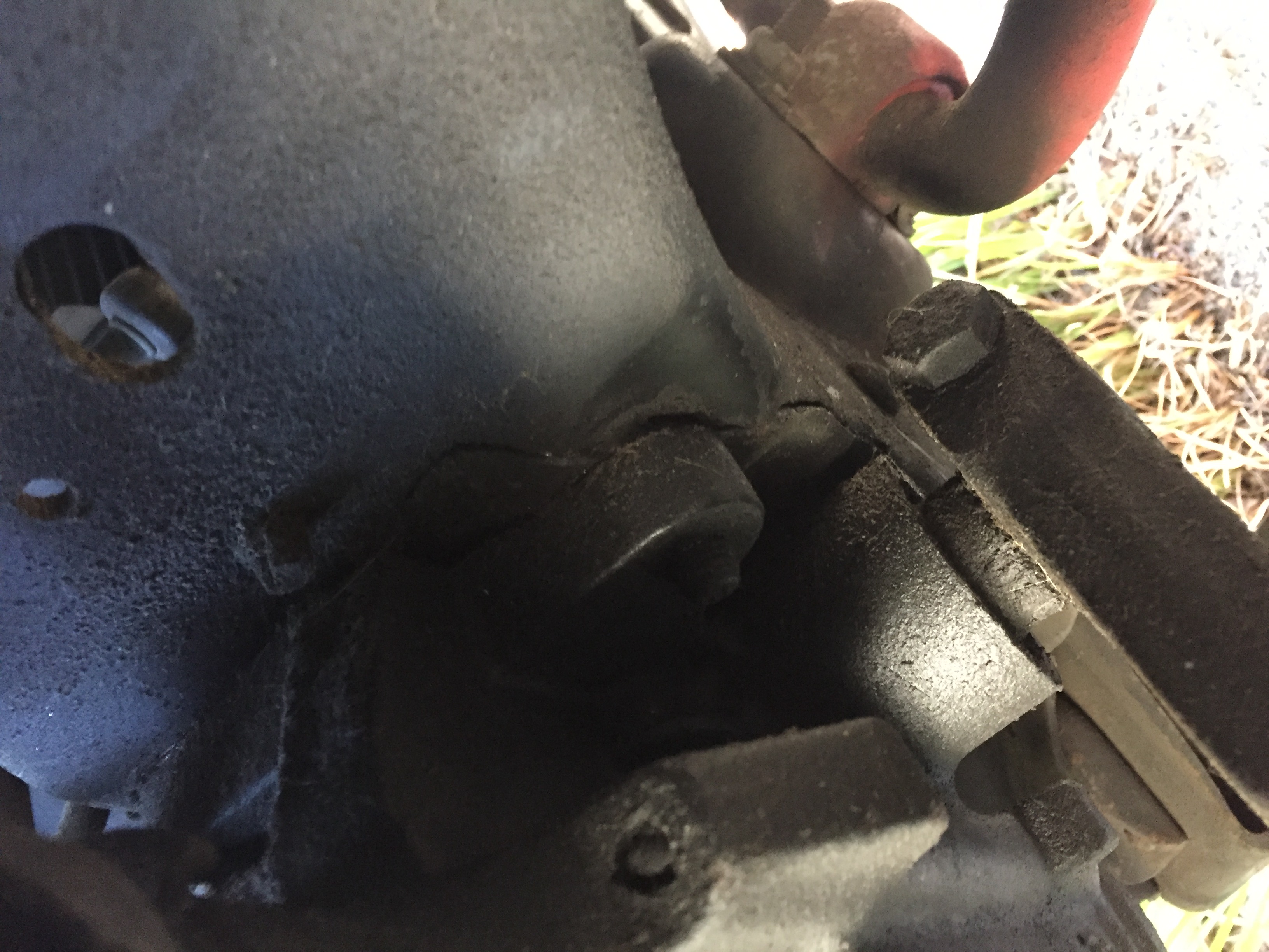

Also, I noticed I have a frame cracked on steering wheel gearbox, when I move the steering wheel, whole gearbox moves slightly. I keep uncovering more and more stuff. Will have to deal with all that.

Concerning the frame cracked behind the steering gear box, this is a fairly common issue. There are a number of kits available for addressing this ranging from a reinforcement bracket that bolts in to a weld in reinforcement. The weld in reinforcement is pretty much necessary now that your's is cracked. The bolt in one can strengthen things enough to limit the possibility of the frame cracking. OffRoadDesign has both options covered. I'll likely do both to my K5 when I get it down to the bare frame. I do not have any cracks, but I also do not want to ever have cracks.

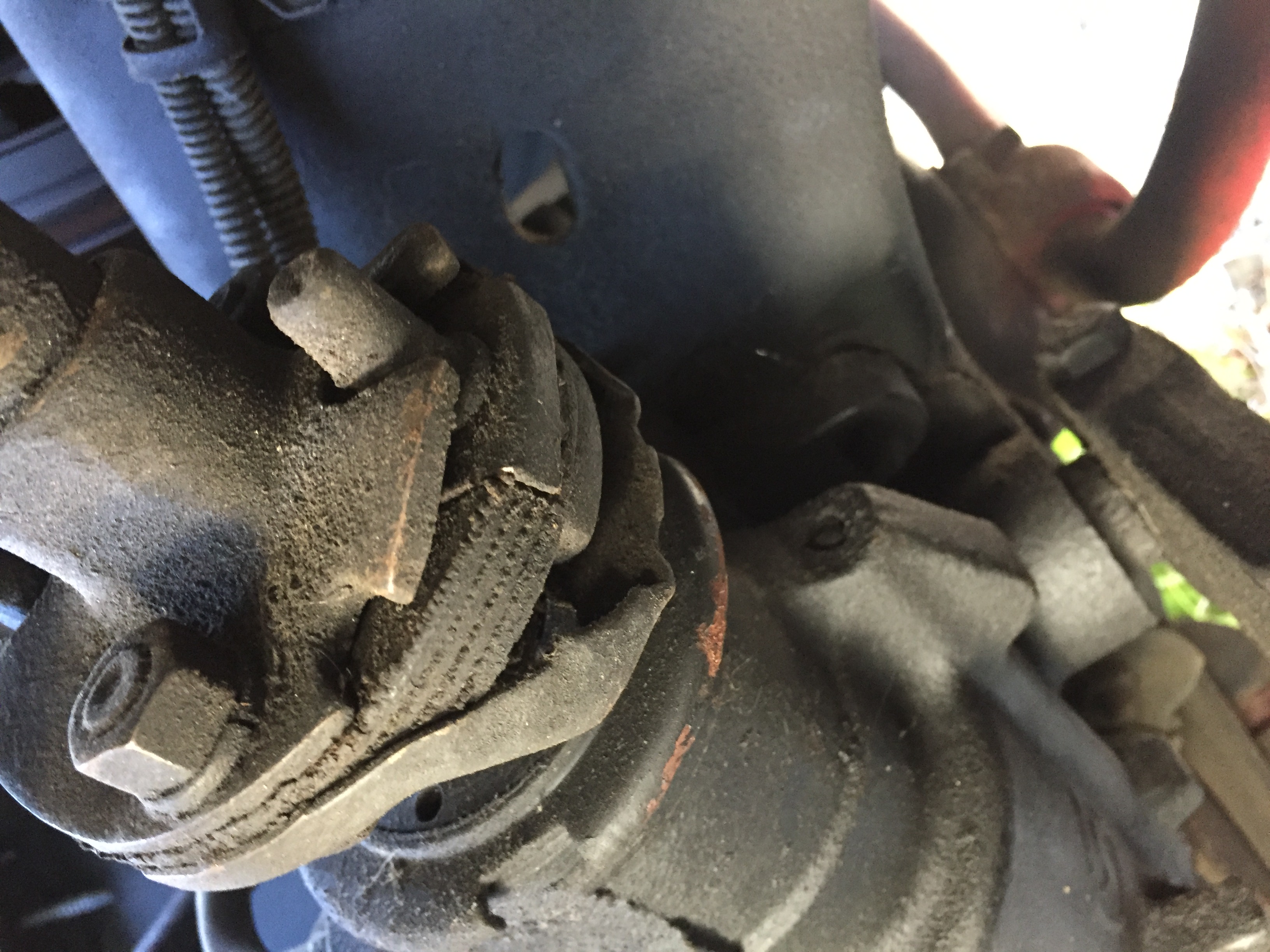

I'm getting back on my feet after the surgery! I recorded a video of steering gearbox
worth noting is that:
- whole box moves
- it hisses on both extremes - turning all the way left or right causes weird noise
Is that at least stock 4WD Blazer 85 steering gearbox? If so I will order these kits to fix it. Also - if I put extra plate between frame and steering gearbox, will it not change whole geometry of the steering system?
