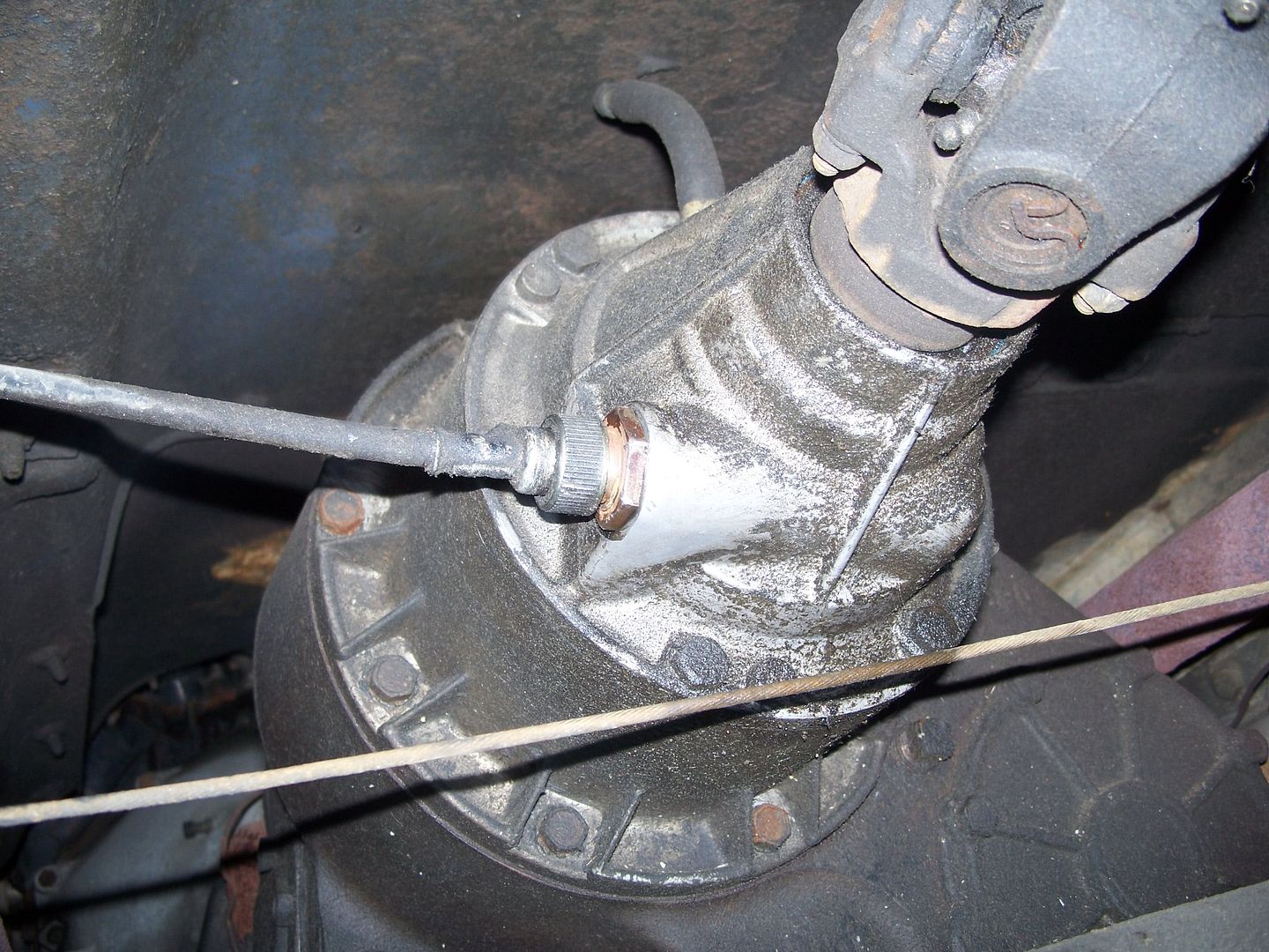

The NP203 in my '74 has a solid yoke at the back of the transfer case and an expandable driveshaft:
I believe that all NP203's came this way.
