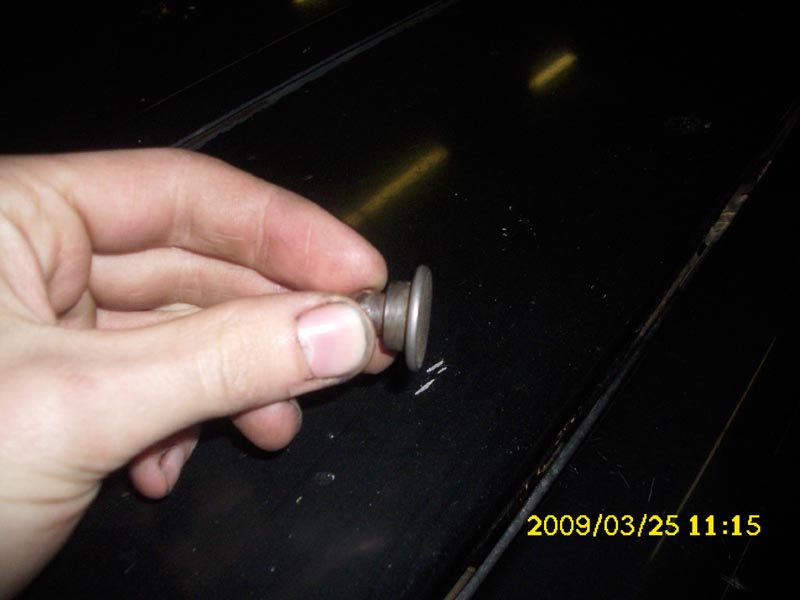

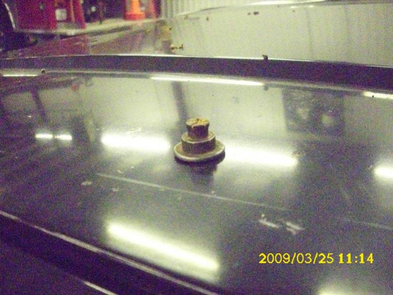

hey sorry it took me so long to post these pictures, but my computer crashed and I just got it working again.
the first and second pictures are the bolt I was talking about.

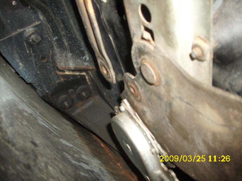

the third is, the arm with the bolt in it.

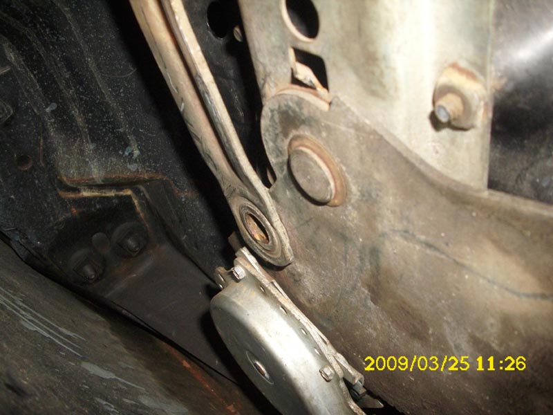

the fourth is, the arm in place but without the bolt.
and the fifth is, the arm moved away from the gear wheel so you can see the other side.

What you have there is the original staked fastener. It is a rivet of sorts. It is not supposed to be off like that, obviously. If you have access to a welder, you can weld it back in. It is meant to be tight against the back supporting piece and give enough room for the arm to pivot. It should have a thin plastic washer under the face of it to keep down on noise.
