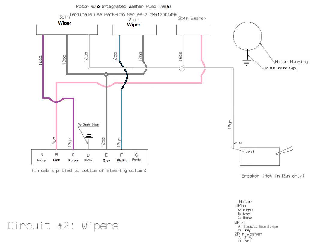

Hey guys, 1985 K5 with two speed wiper (non delay) on the column. Wiring removed and installing a painless harness.
Trying to figure out where to route the wiper hot wire.
Heres what I have:
Column
Pink
Purple
Black
Grey
Black/Blue
Wiper Motor 3 Wire Plug
White
Purple
Gray
Wiper Motor 2 WIre Plug
Black/Blue
Grey
Can anyone help me connect the dots?

Figured it out, maybe this will help someone.
Thanks
