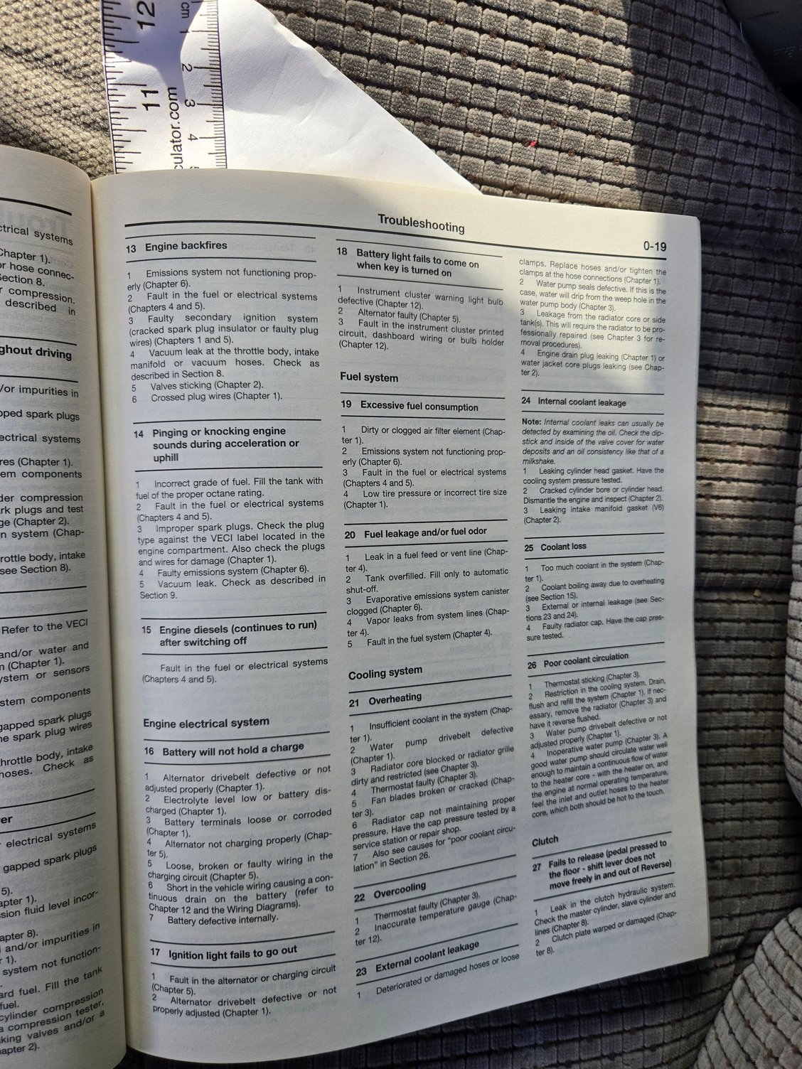

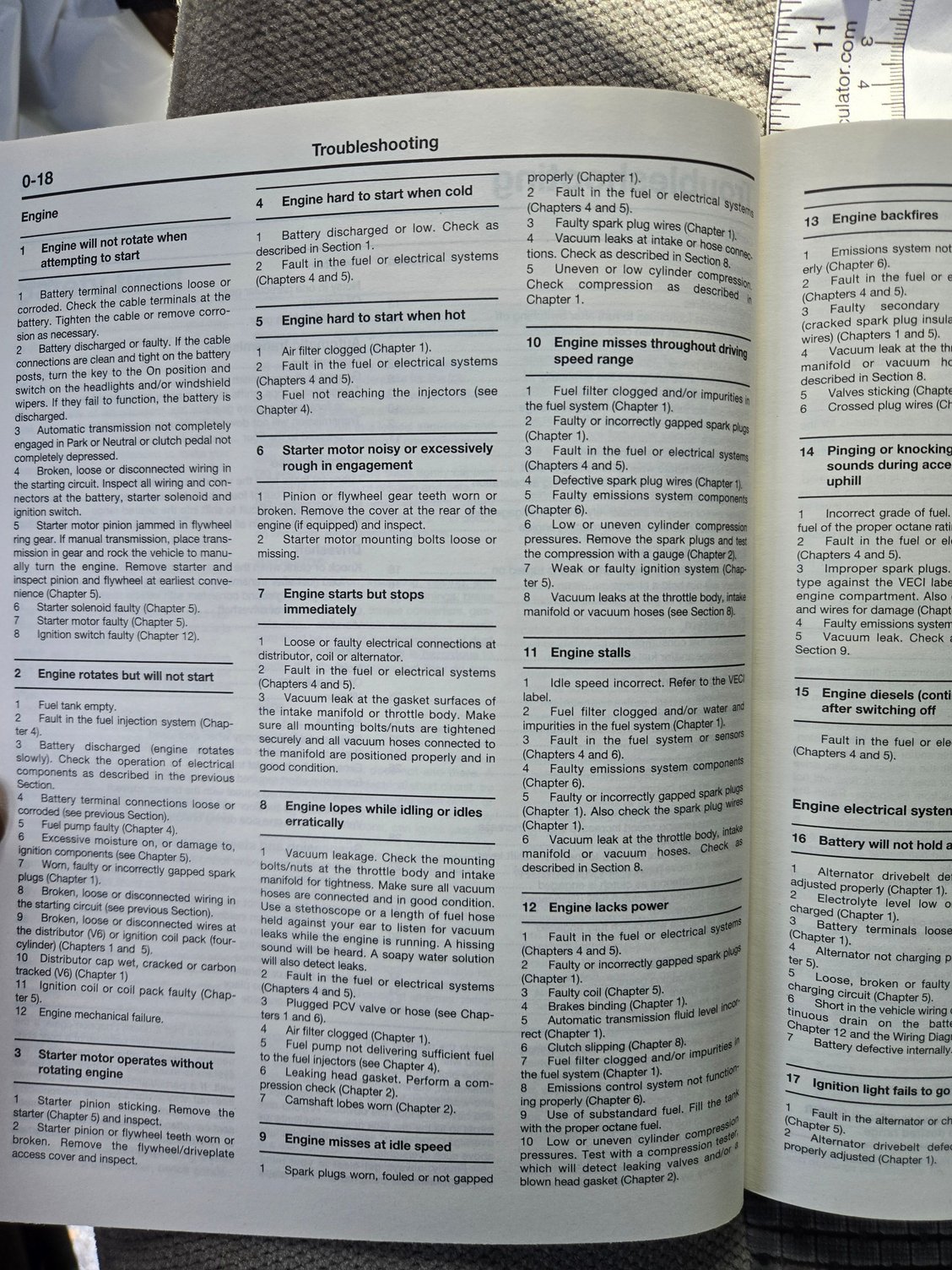

This all I have left to be able to offer to you at this point. I can send you something from the book, if you want to see a specific problem rom the pages.
Old Jul 16, 2025 | 07:58 AM
Goofy98's Avatar
Joined: May 2025
Posts: 9
Goofy98 is on a distinguished road
Sorry for not responding TheJimmyMan. Thank you so much for these pics of manual, of which I do not have ....will troubleshoot everything it says. Again thank you for all your help sir
