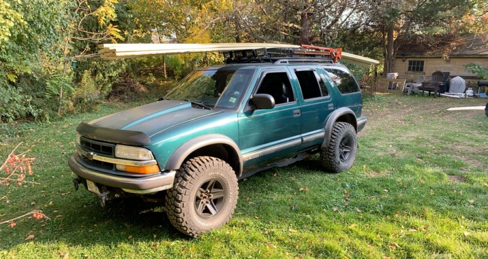

I ran 31x10.5 on my 98 Blazer without issue and used 2" spacers on the rear to make it more even.
I have 32x11.5 on Iroc rims currently with ZR2 axle in the back and front. I also have zr2 flares installed so I cut a lot out already and I still have problems rubbing on a 2" shackle and crank and a 2" body lift. I rub the frame a little bit and then I hit the fender or the wheel well under flex, have yet to grab some buddies to figure out where I'm hammering or cutting but thatll be in the summer when I replace my encoder motor.

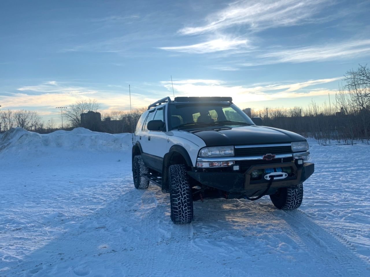

Thats a nice blazer! Kinda looks like my 99 with a 2.5 lift and zr2 flares, axles are getting rebuilt atm lol...
Only got 30.5s for now, but plan on going to 31s without the body lift, or 33s with a BL...
