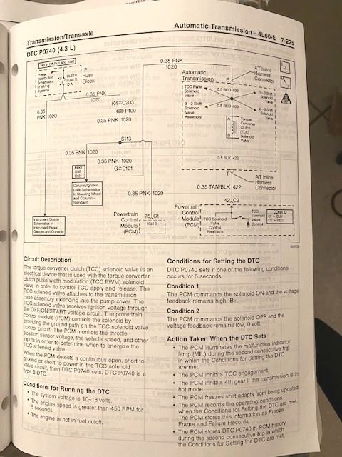

This is a lot but maybe you can find a common needle in this haystack:
George
