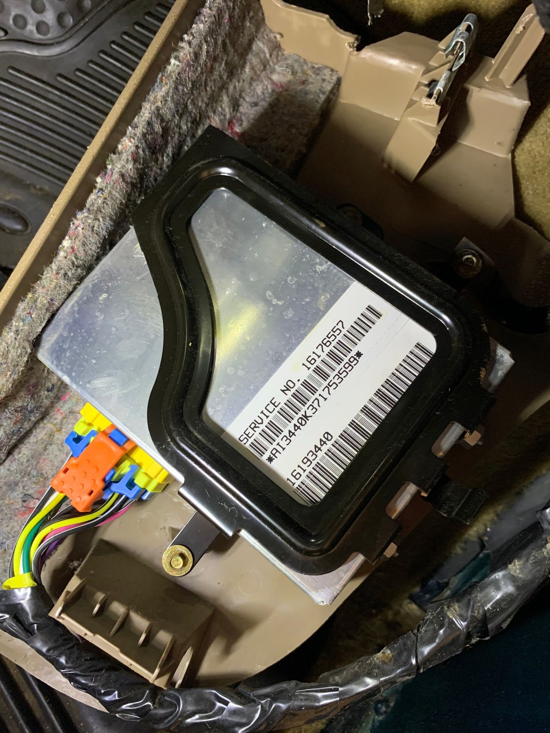

Hey everyone! My 4x4 is unresponsive. There are no lights, no clicking, nothing. I did a bunch of searching to find where my TCCM is, and I haven’t had any luck. It is not under the passenger side kick panel, and I have attached pictures. Any idea on where it could be? Or what would make my 4x4 unresponsive at all?
the only thing I found was the air bag module.

Thank you for the info! I actually just pulled the dash and found it. It ended up being like the 95-96 where it’s in the center under the dash behind the cigarette lighter. I have checked the fuse in the driver door/dash area and it looks good. Are there any other fuses? Not sure where to go on it now. Do you think it’s worth getting a new three button selector switch and trying that? I do need to replace the vacuum lines under the hood, but I thought it should at least light up or try and engage if it was only the vacuum lines.
