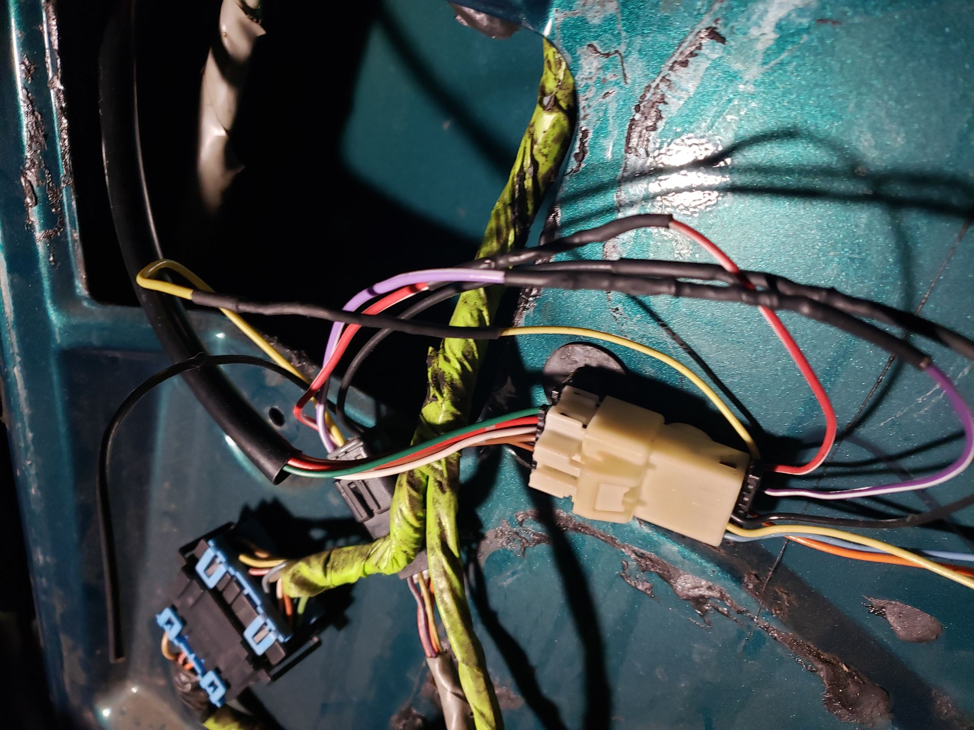

Installed new 99+ side mirrors. To make them work I cut the wiring off the old mirrors and the harness off the donor truck and spliced them together with the help of wiring diagrams available here (thanks again forums). Pretty straightforward, only 4 to do. This way, if I ever need to replace the mirror, it's plug and play.👍

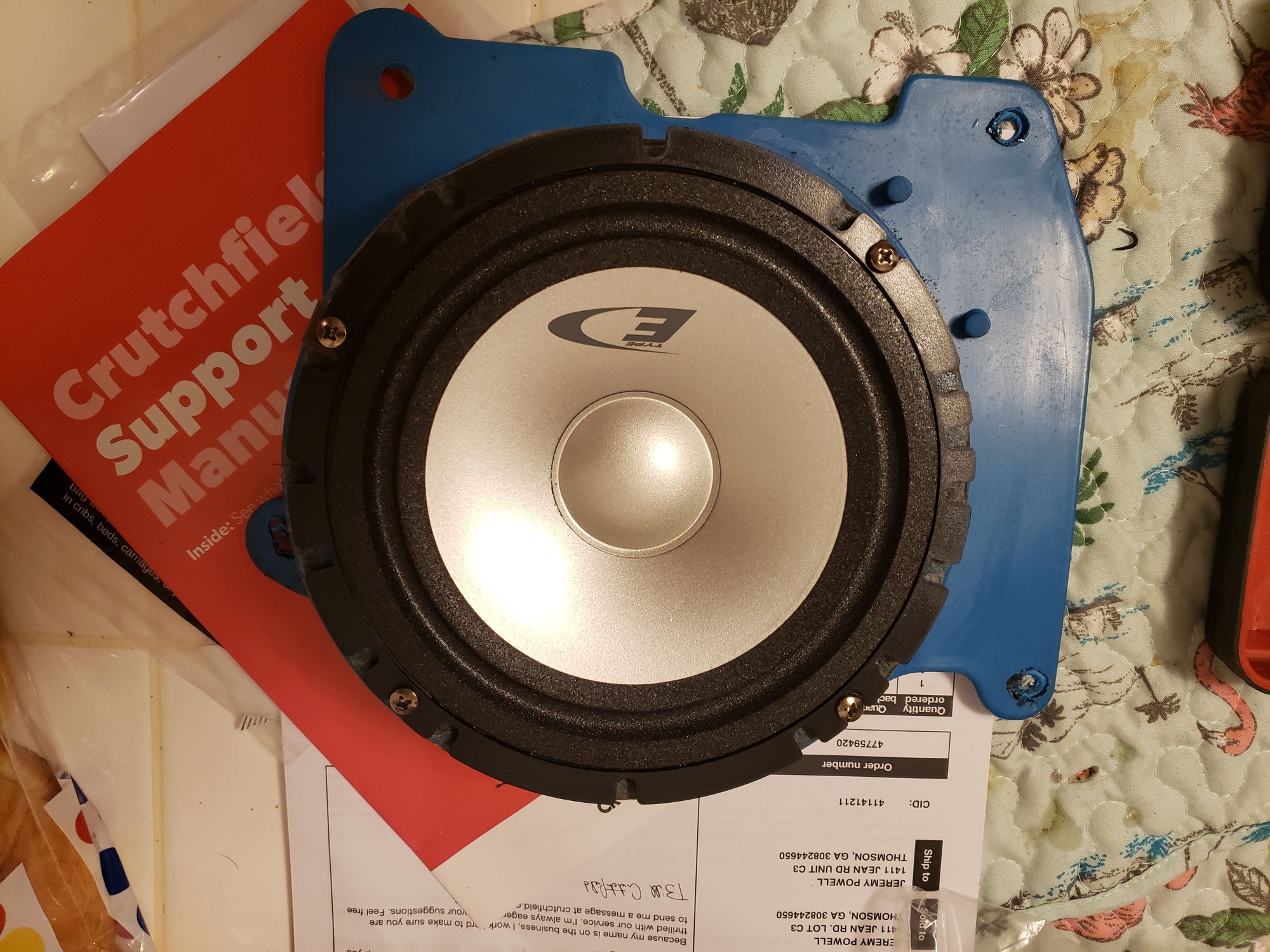

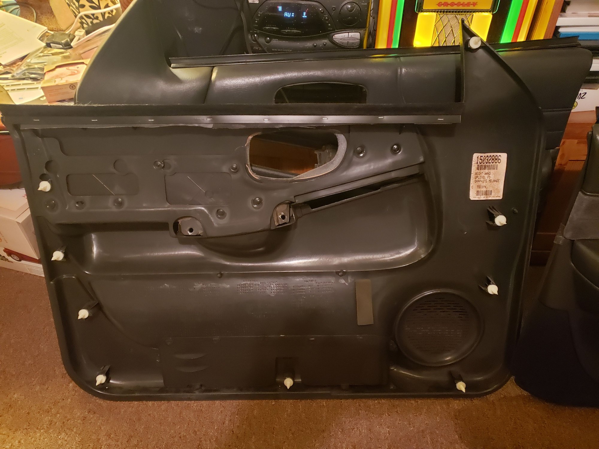

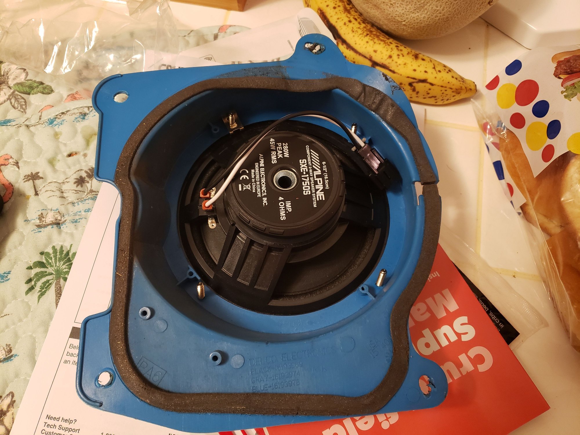

So today I took the passenger door panel off to begin a total rebuild of the door. Started with upgrading the power mirror to 99+', which required some wiring the different plugs so they would play nice together. Piece of cake, thanks forums. Next was the power window regulator. This particular task kicked my entire ***. If you ever have to do that job, it would be well worth it to hire a helper. I had to remove the speaker baffle to allow for wiggle room and still caught hell.
Since I had the baffle out, I went ahead and upgraded the speaker with an Alpine component speaker. Lastly, I prepped the panel with new retainers and a new pull handle. All that's left now is to mount the baffle/speaker back on the door and reinstall the panel. Whew, what a job it's been! But will be totally worth it when I'm done. Hopefully will get the driver's door done tomorrow. Thankfully I don't have to mess with the regulator on that one.
Almost forgot to ask, should I put some kind of lube in the tracks for the rollers on the regulator?
Couldn't get to that top one to replace the rivet but I think it will be ok. Tested and worked fine.
Soldered the two plugs together so if I ever have to replace the mirror it will be plug and play.
getting the wiring harness to connect with the speaker was hell. Had to take the plastic off the terminals.

New retainer clips and handle.
