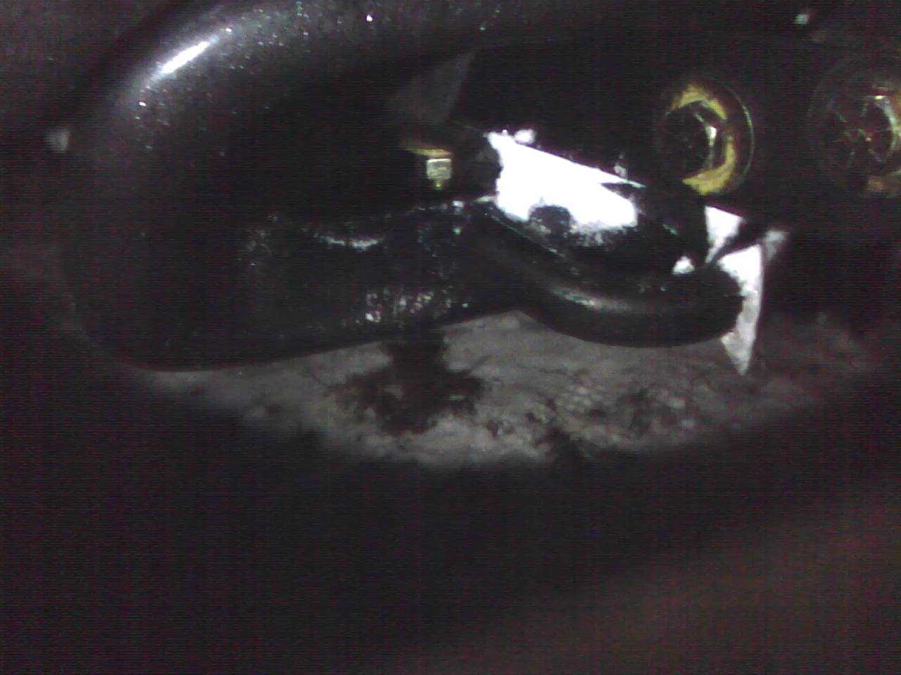

late to the party i know...well i have grille guard and tow hooks .
just added longer bolts to the steel angles and frame worked just fine. i didnt even have to notch the valance to fit them.
but granted mine is totally homemade from angle steel and scrapyard find.
(came off a cherokee ) works though.
i will have to get pics, i think the ones in album dont show that at all.
be sure to post up what the finish result is...

the steel angle slid into the frame and i drilled out the tow hook and the mounting holes to take a slightly bigger bolt . the tow hooks went right on bottom of frame under exactly where they were mounted. the steel angle took there place inside the open end of the frame.
i can get more pics if that helps. night shot not the best.
What size bit did you use for drilling, and what size bolts (diameter, length)?

1/2" dia. grade 8. length was 2.5" i think. will double chk with pics.
i have pics in the album...not close up though.
