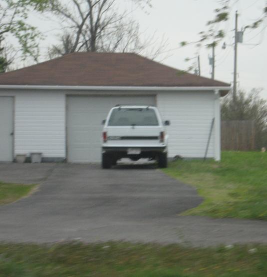

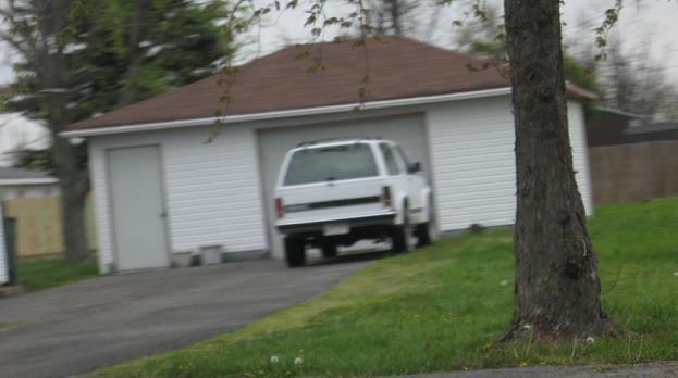

Turns out he had to work late and by the time he got home it was too late to get over there but he's off work tomorrow and I'm supposed to go over there when my cousin gets out of school (well.. technically not my cousin but close enough so thats the way we look at it)
I did find out that yes it was drove some and yes I could hop in it and go down the road if I wanted but the battery on it is someone elses so I'd have to pull the one off my taurus to put on it (no big deal the taurus is being parted out/ scrapped soon anyways)
from the sound of what I'm being told so far it just needs window/muffler to pass inspection..
I have asked a few times and no one seems to answer.. what else should I look out for? (i've read over common problems but I'd also like personal opinions) and YES I know these pictures are horrible but I was in a hurry.

ANYWAYS.... (I'm going ot cut this short) I went over there he pulled the battery off his truck stuck it on the Jimmy. He turned the key a couple times and it fired right up.. no smoke at all and ran/idled great the 4x4 works on it.
I drove it about 5 miles and it drove great. the reverse and everything seemes fine.. and the throttle response.. amazing lol (first time I've ever personally drove one of these things)
it doesn't leak or drip anything... and here is the thing. the chassis and drivetrain are all a 94 and it has a late 80's body dropped on it.. he is the one that put the body on and at the time he didn't know until he had it about done. but apparently it had been wrecked and he wasn't told (he pointed everything out to me) the door wont shut flush because the piller is like warped and they fixed it all you cant tell unless you really look for it.
BUT the windsheild needs to be replaced and the muffler needs to be replace to make it street legal.
I don't think I could handle the body work it needs.. (not too bad but idk if I'd want ot have it done) .. we talked for awhile.. (i was there for a couple hours) and we were talking about body swaps etc. then I got to talking about motor swaps (he's done a lot on the s10's and previous jimmy/blazers he's owned) and he did tell me if I wanted to use the motor and stuff in another one he'd help me swap everything for free and he'd teach me some stuff (he's a great guy and somewhat like an uncle) and of course i'd be keeping the rest for parts and stuff and he has a set of nice crager wheels I can have to put on one.
SO if I happen to find a blazer/jimmy thats complete enough to do the swap and possibly rob parts from this one to make the other run. then I'm going to.. it'd cost me about $800 to buy a used motor and have someone put it in if not A LOT more.. and plus i get to keep the rest of the jimmy for parts and the set of cragers...
but the important thing is I'm NOT buying it UNLESS I already find a roller that is good enough for the project and then I'll get it and tow it to his house for us to work on.
