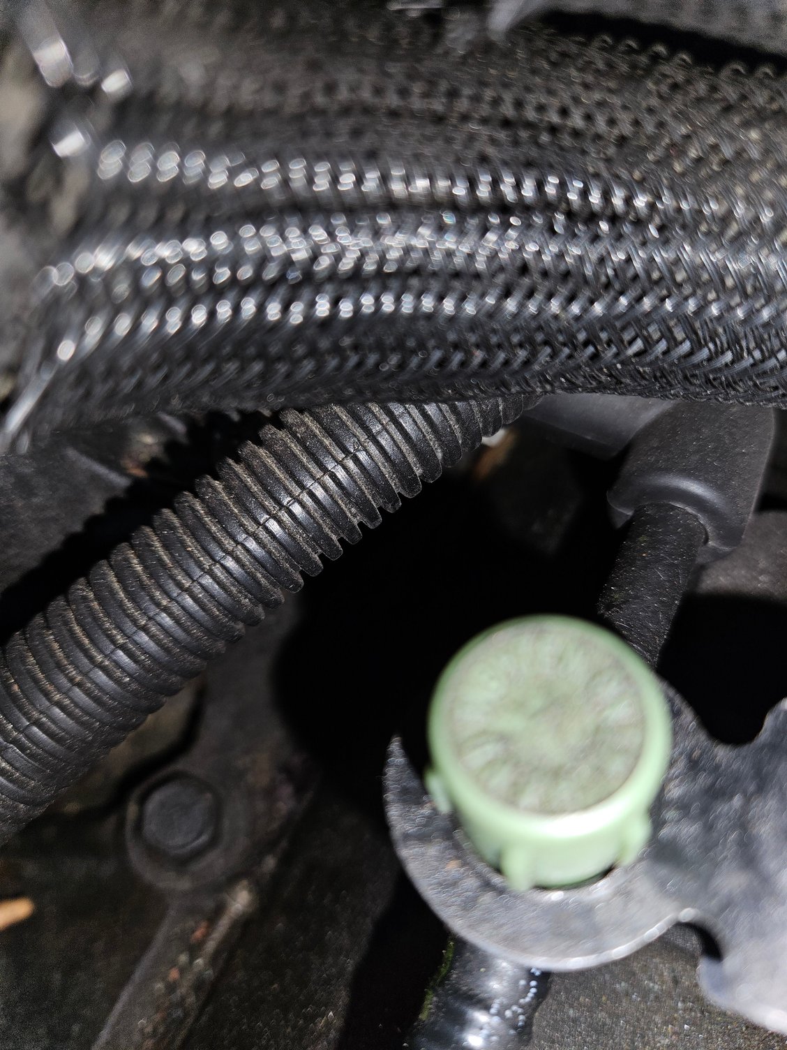

Thank you again for getting back to me so quickly. I am including a couple of pictures of what I believe to be the purge valve by the engine. It is located on the pax side toward the back of the engine. Is this the purge valve where I remove the line at this end and then remove the line on the charcoal canister and blow air threw it checking for any blockage. The connection on the valve by the engine looks Ike it is just forced on...no clamps that I can see.

Your looking at 10 in post #2, the service port.
This is what you are looking for:
https://www.rockauto.com/en/moreinfo...g%2BxZSRYNY%3D
