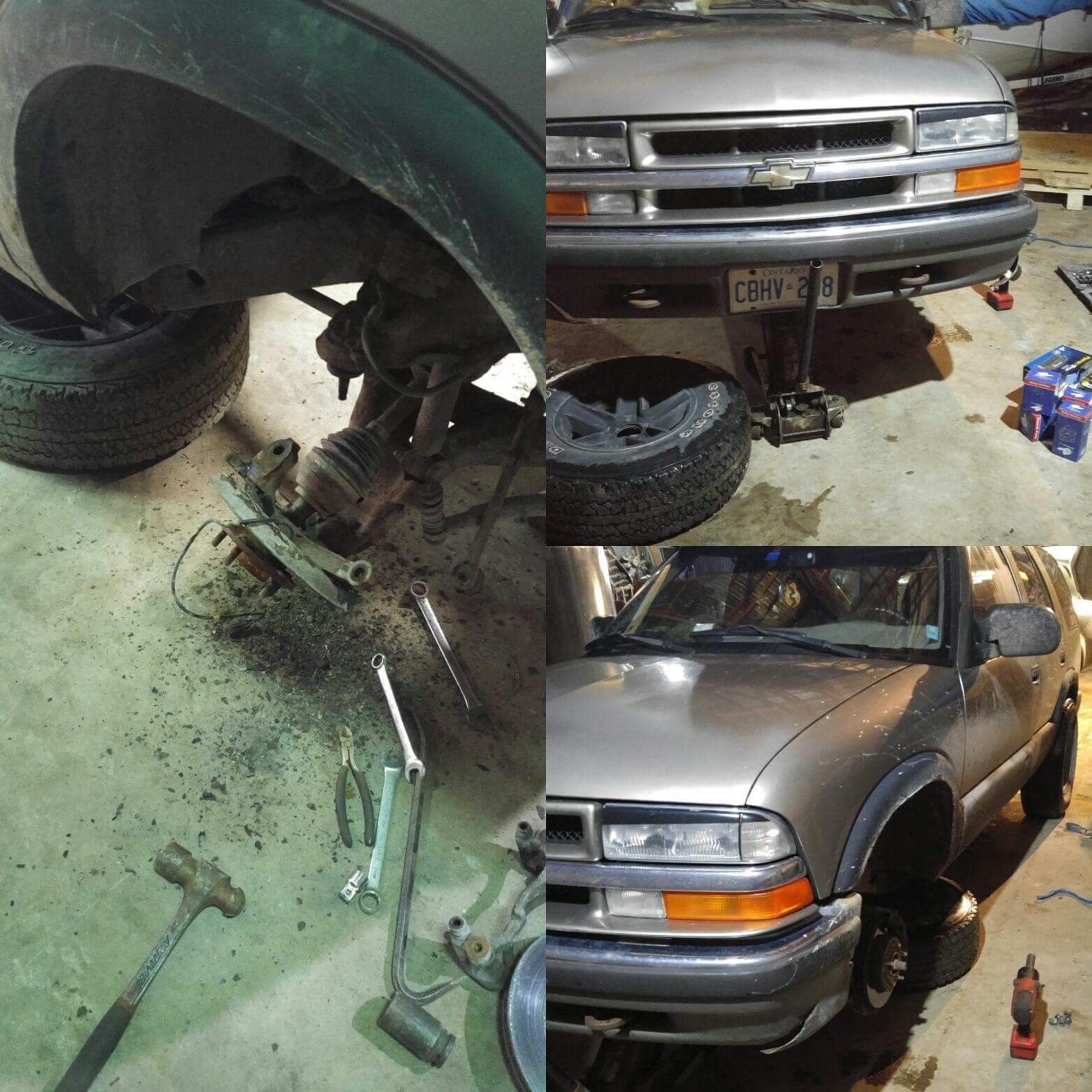

I used the Dorman pin kit on my bottom pin on the drivers door, been there for a couple months and it's still fine. Are you guys sure nothing is bent in your hinge assemblies?
