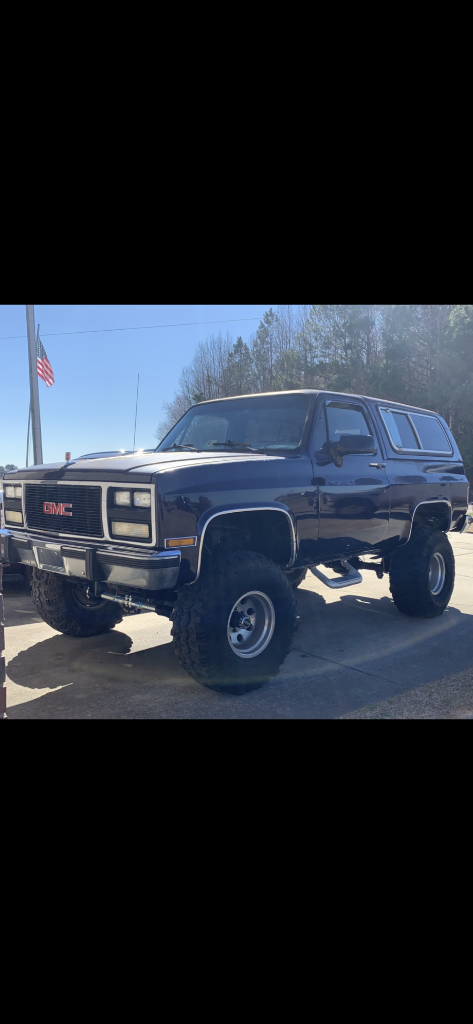

I have a 1991 GMC Jimmy/K5 I plan to LS swap. It currently has the tbi 350 with 4l60/700r4 trans with 241c transfer case. I want to swap in a 6.0 Ls with 4l80e and keep my 241c transfer case. What will I need to keep my stock 241c transfer case ?
