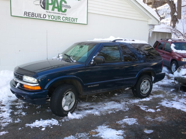

My son just purchased a 2001 4x4 Blazer and I was wondering if there was anything I should look for as he is not mechanically minded. He purchased the car without me being with him and I finally got to see it today and the only thing that jumps out is the ABS light is on.
Is the ABS a common issue with Blazers? He purchased it at a small used car lot and I told them to fix it before we pick it up so I am not too concerned.
The vehicle has 154,000 miles and for the $800 he paid, I really don't see how he could have gone wrong. Under the hood looks great and no obvious signs of any leaks anywhere.
Thoughts?

Jack up the front and check the whee[ hubs. Grab the top and the bottom of tire and wiggle it to see if there`s play, if so the hubs (or the ball joints) may be bad. do the same side to side, tie rods, idler arm pitman arm

Have you heard how it runs,did your son get a chance to test drive it and if so did he notice anything that might feel out of the ordinary?I know alot of times a quick test drive doesnt bring out any noticible problems and its not till several days later the quirks start to show up.I would check all the fluids that would give you an indication how well this vehicle has been maintained.Look underneith and check for rust and other issues that may be present.Do a car fax search this might show you some of the vehicles history.
