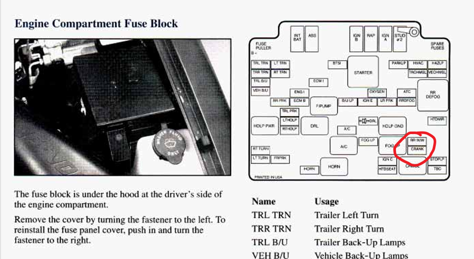

havent had time to check things out yet, where do i find the crank fuse?..Thanks for the reply, will check everything out when i have the time...Thanks again.

From your owners manual:
