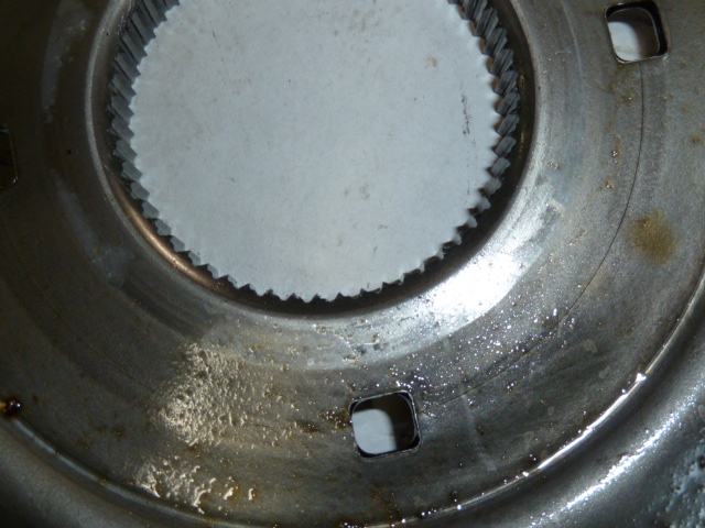

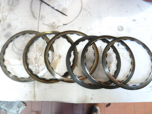

Your Blazer will not drive in 3rd gear, when your friction plates look like that ones....
The sunshell has already stripped the splines, it has only 106000 km on it. I am wondering how the preowner has used this car...

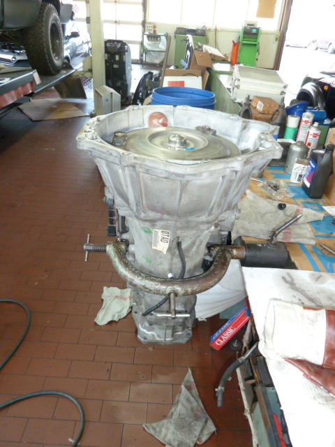

Tranny ready for going back into duty. It was a pain to clean the entire assembly from the deposits of the burned plates...
