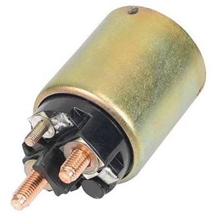

The solenoid you're after will look like this:
As mentioned, they're mounted directly to the starter motor. You'll find a thick wire on one of the larger threaded terminals going strait to the battery, and a smaller wire plugged into it that is the signal wire to engage the starter.
