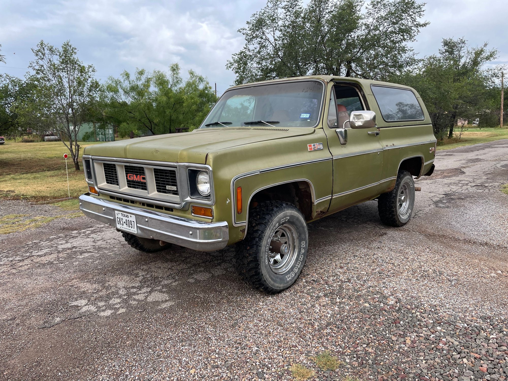

I have recently acquired a 74 Jimmy. The removable top seems to have been painted green and I would like it white. I don't know much about these but was thinking I could have it media blasted (plastic) and once stripped then primed and painted white with a satin finish.
Anyone with any experience with this? Is this top fiberglass or composite?
