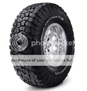

these tires are good for sand mud snow and these are the ones imma buy !
http://i1130.photobucket.com/albums/...nch3095r15.png
