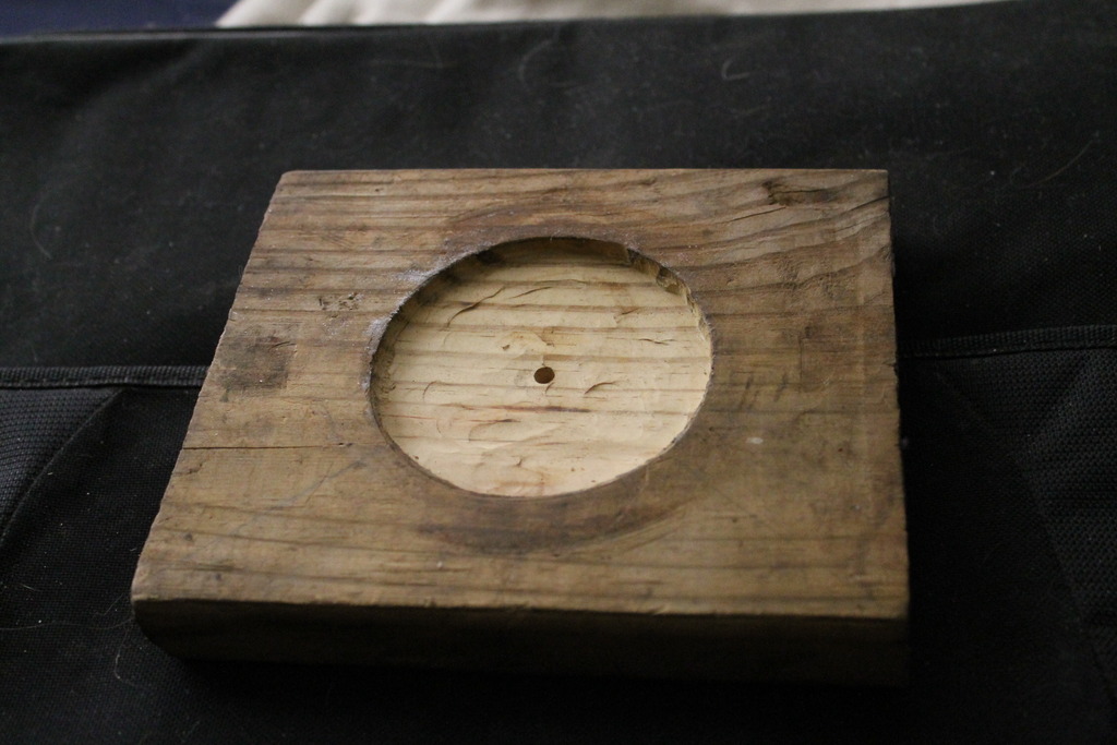

Next I decided to change the rear main seal which came with gasket set I'd bought for the intake and heads. Once again I got out my trusty seal puller only to find out I couldn't use the stupid thing to get it out. I think I've been successful with it Twice in ten years. A flat blade screwdriver took it right out though. I decided I should put the seal in properly and called to rent a seal driver set from AutoZone. Long story short(ish) I drove to town only to find it wouldn't work even though I'd been assured it did. Then I called around. All the sets to rent and buy are flat discs which won't work since the crank protrudes slightly past the back of the engine. I had to make a Redneck driver out of a piece of 1" deck board. Popped it right in and drove it flat with no issues. I also changed the camshaft push plate gasket while I was at it.

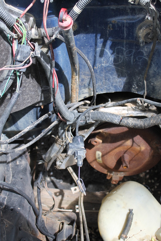

Next I spent a few days cleaning out the mess rats had left in the engine compartment. That was a chore. I vacuumed, disinfected, washed, and re-washed it and then spray painted everything I could. Yesterday I got in there and fixed as much of the wiring I could which they had chewed. I've still got a couple of mystery wires without ends so I'm hoping to figure that out.
[/IMG]Next I spent a few days cleaning out the mess rats had left in the engine compartment. That was a chore. I vacuumed, disinfected, washed, and re-washed it and then spray painted everything I could. Yesterday I got in there and fixed as much of the wiring I could which they had chewed. I've still got a couple of mystery wires without ends so I'm hoping to figure that out.
