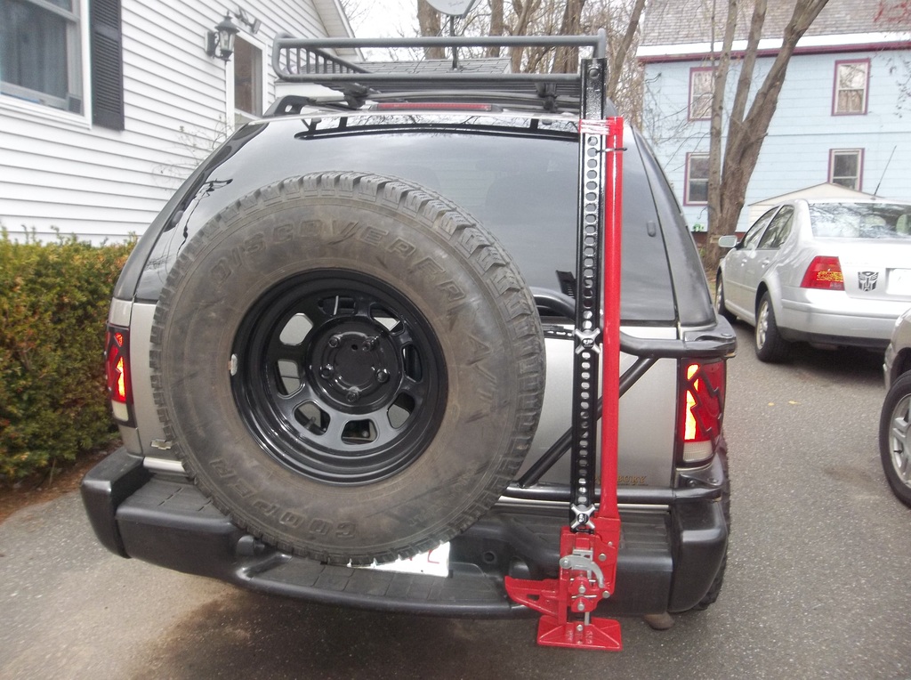

New hi lift mounts I like em
Attached Thumbnails what have you gotten done on your blazer today?-100_1373.jpg
