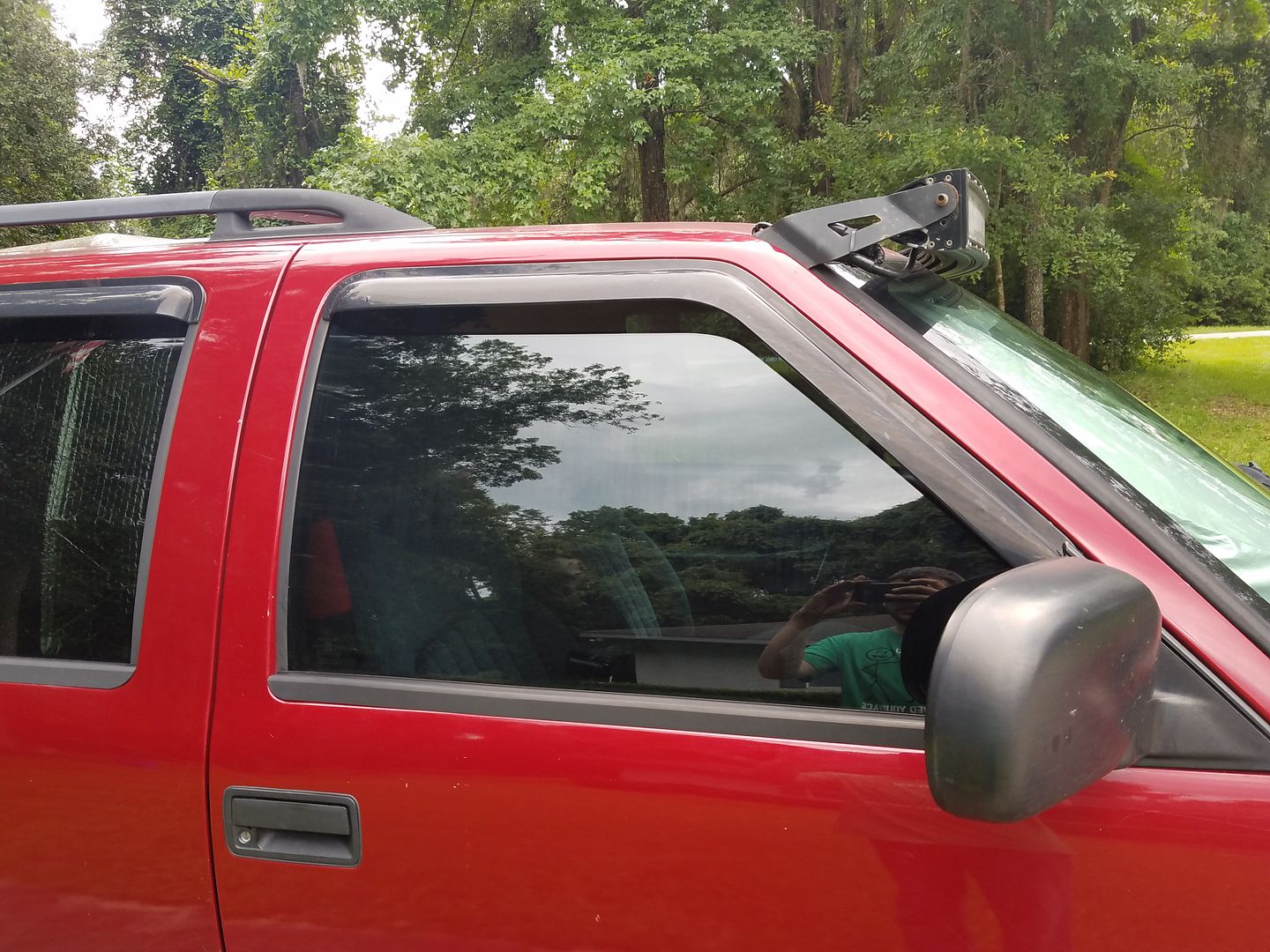

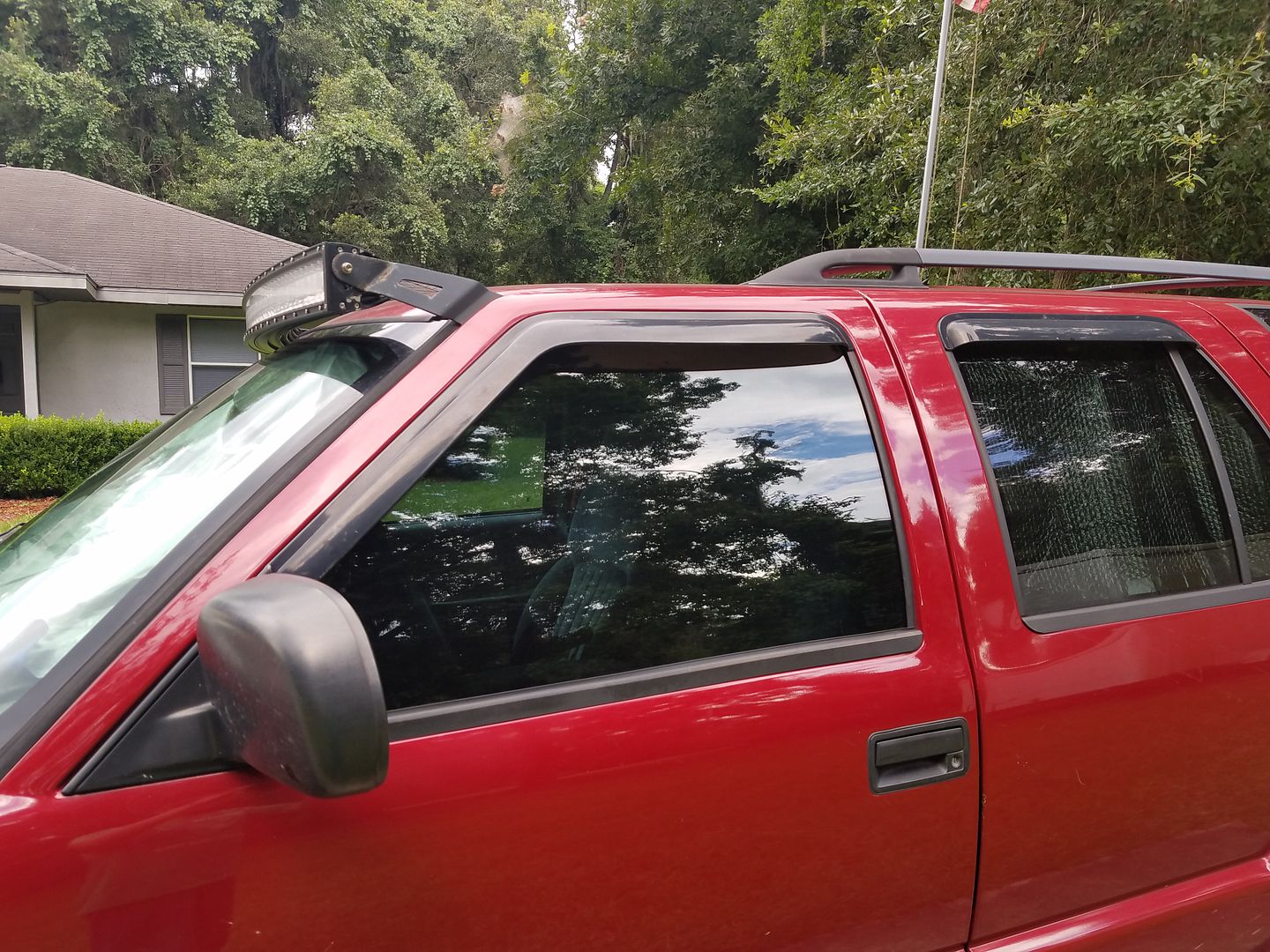

Yesterday I threw in my DIY tinted windows. They came out okay. Far from perfect, but to be honest I wish they were a little darker, so I may take a crack at tinting another set with some slightly darker tint and install those.

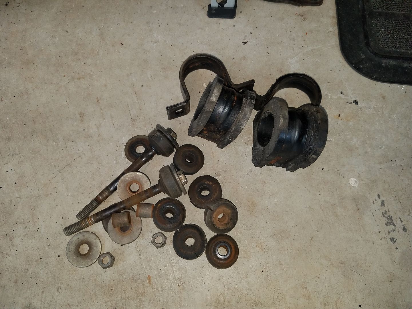

Today I finally got around to installing my urethane sway bar bushings and end links. The old frame mount bushings were splitting and the end links were splitting, so I figured it was about time for a change/upgrade
Had to swap the grease fittings on the frame mount brackets since the straight out ones that were on them, interfered with the skid plate. Luckily in my massive inventory of junk I had some 90 degree grease fittings just laying around :P
They sure look better, hopefully they perform just as good and last a long time pretty sure they old ones were originals (the frame mounts at least, I replaced the end links about 3 years ago) so they have to last 14 years to beat them
