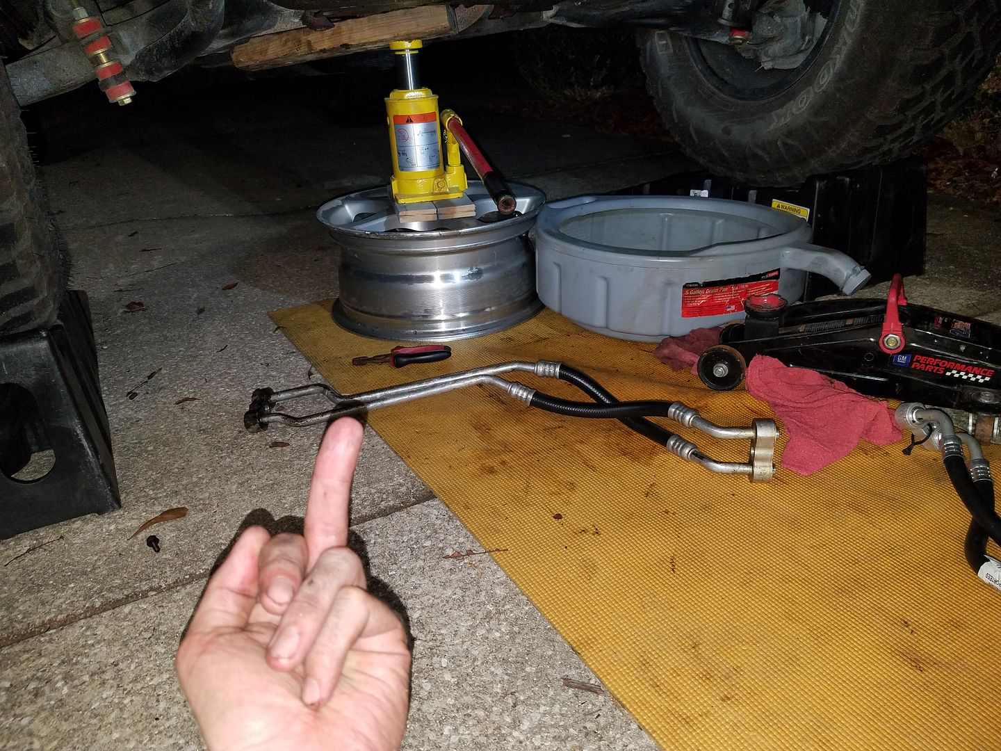

Started messing the the oil cooler line. After finally managing to get the bolt off holding the line to the manifold on the engine, making a complete mess in the drive way, I couldn't get the line out of the engine bay... About the time I realized I'm going to have to jack the motor up to get it out, I got pissed off and went inside for the night lol.
So tomorrow a friend of mine is going to help me get it done...

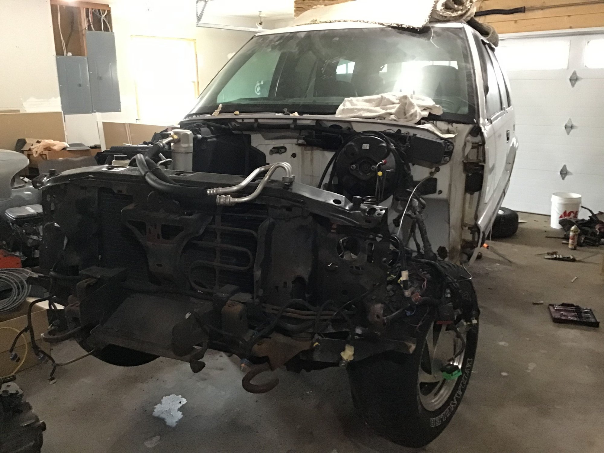

Started connecting all wiring and installing/hooking up rest of the engine accessories. Realized water pump was off just a bit not allowing the pulley to properly mount. RMA'd it - same problem on another one. Found one that worked with the right stud pattern - did a happy dance and had the owner put the pully on (17 year old son's blazer). Got the right TBI plugs pigtails in - and about 80% of the electrical hooked up (hooray!!).
Went to put the one good exhaust manifold on, damn thing doesn't fit. Middle two on - front two bolts - bottom ones off 1/8" or so. Realized I'm suffering from the stupid shrinking manifold issue, have a spreader on order so I can get them spread and installed. Waiting for my driver side manifold to arrive - the old one has studs sheered off for the exhaust and I couldn't drill them out (tried....but failed miserably).
Foot slipped while I was in the engine bay, want down and hit the front diff cover. Pulled off like 1/2" of gunk with my foot - and instant leak. Looks like the front differential service has been bumped up to the top of the priority list.

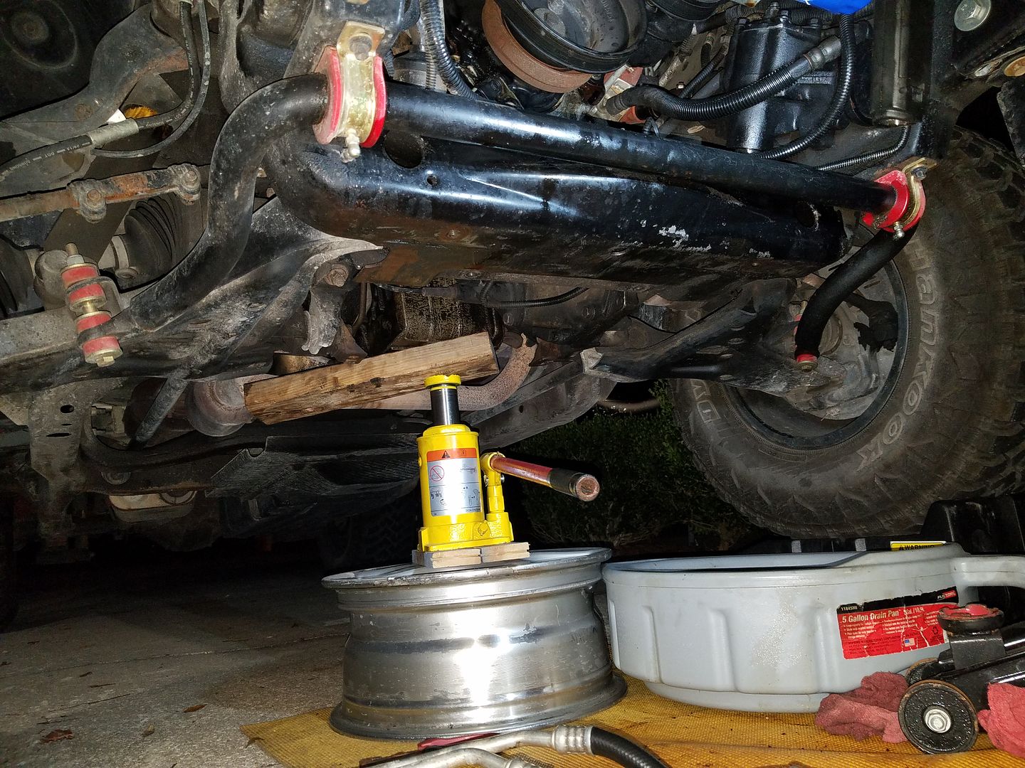

Got that little sucker knocked out tonight though! Just got to throw the skid plates back on, but the hard work is DONE
Managed to get enough room to remove it with a combination of a random spare wheel in the garage, a bottle jack, some scraps of wood, and a hope and prayer that the oil pan wasn't going to fracture on me in the process lol.
After getting it to raise about an inch or so, the line almost fell out...
New one went right back in its place with no issues. Let it run up to temp, no leaks at all.
What a total PITA...
