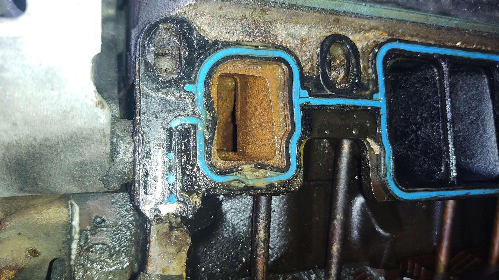

That being said, I dove in today after I managed to get off work a little early and actually got further than I thought I would. At this time, the new lower intake is installed and torqued down to spec, with the plastic style gaskets... so that's what it's getting lol. I did plan on flushing and using green antifreeze though, so maybe that'll help keep these gaskets alive a little longer?
Pretty sure I found my gasket blow out that caused the loss of coolant. The very rear of the passenger side looked the same, but it tore apart when I pulled the manifold off.

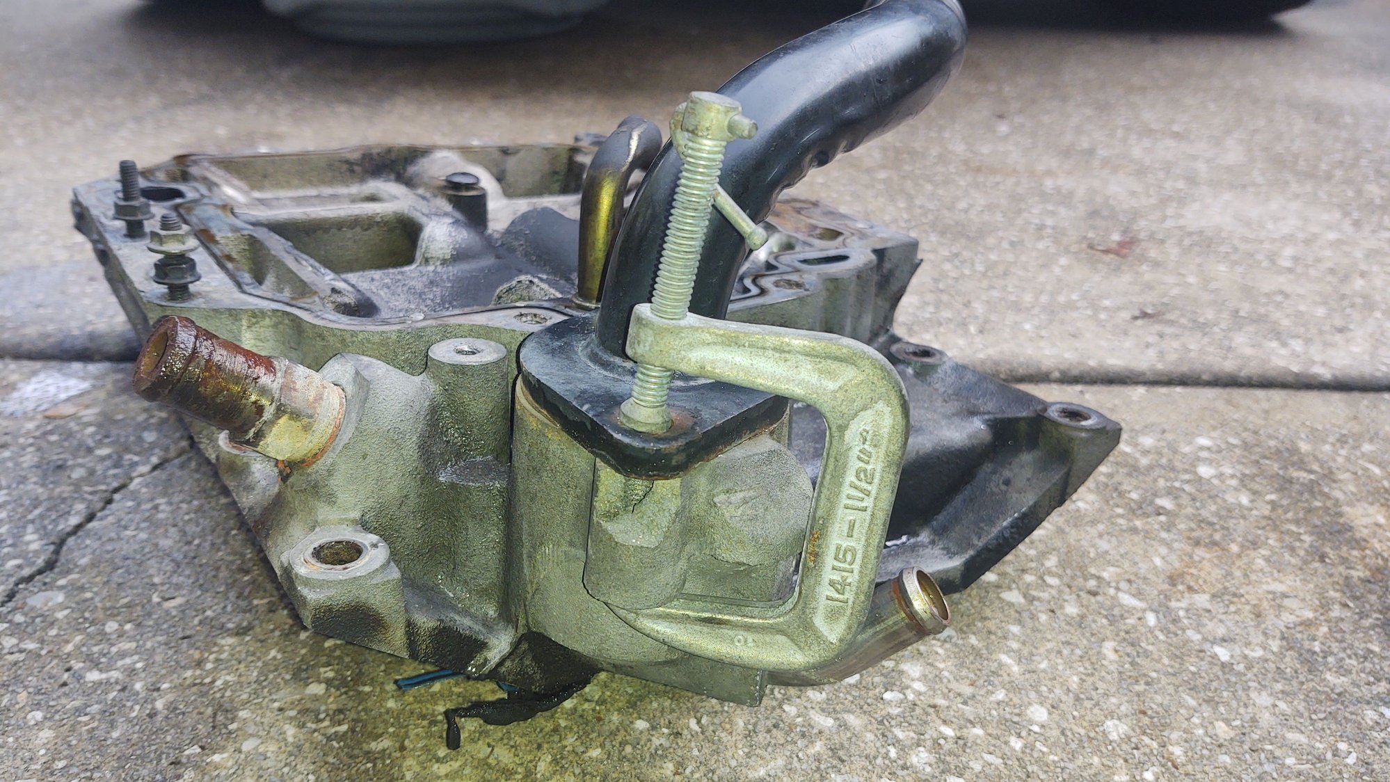

Can see my trusty 'ol faithful C-clamp that's held the thermostat housing together since the last time I changed the thermostat and the lower intake cracked at the forward most mounting location, that was about 4 or 4 1/2 years ago. Never leaked a drop there lol
So everything got cleaned up really good, ready for new gaskets and the manifold installation
