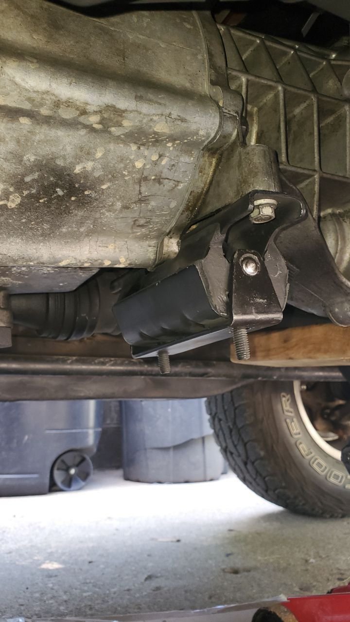

Replaced transmission mount and painted the cross-member. Oh jeez so nice. WOW!

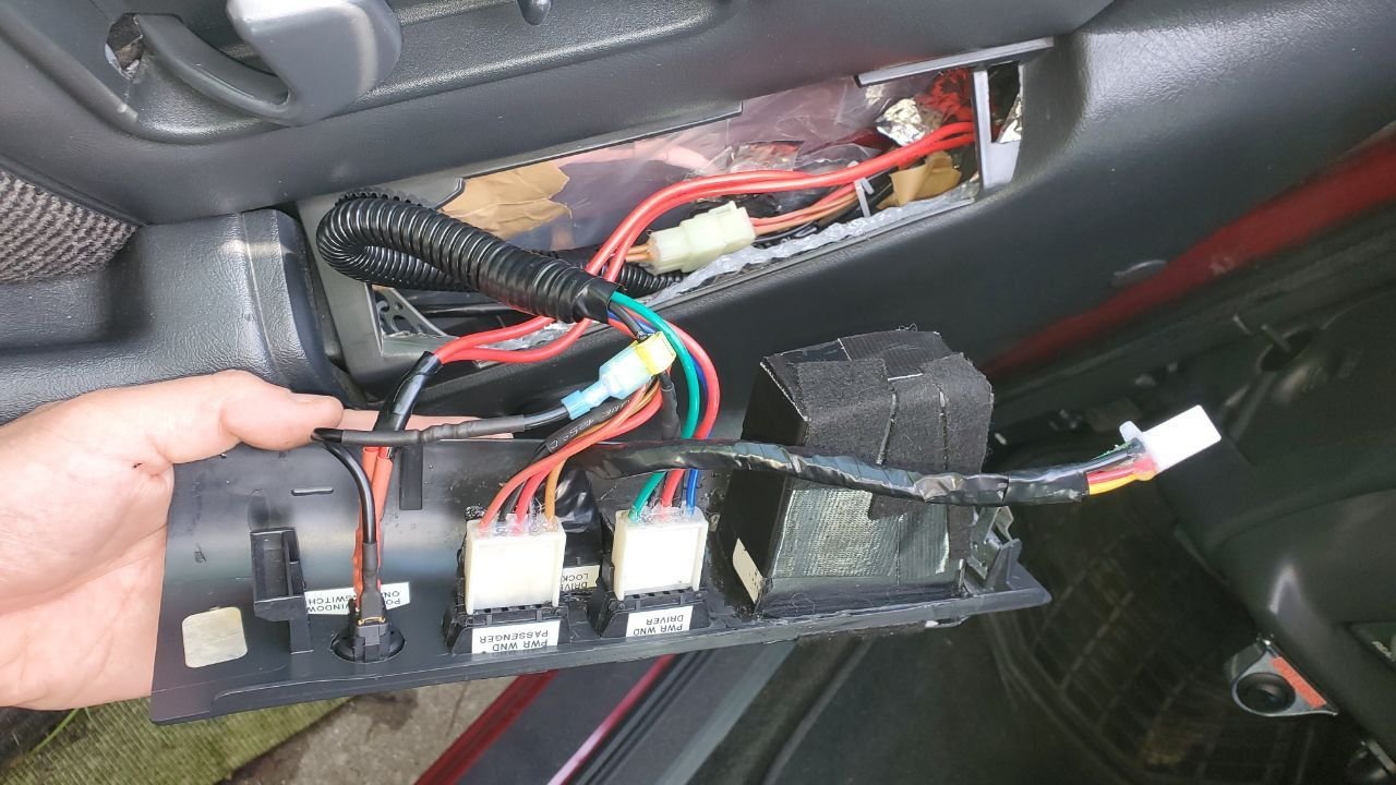

Also added universal remote locks and power windows.

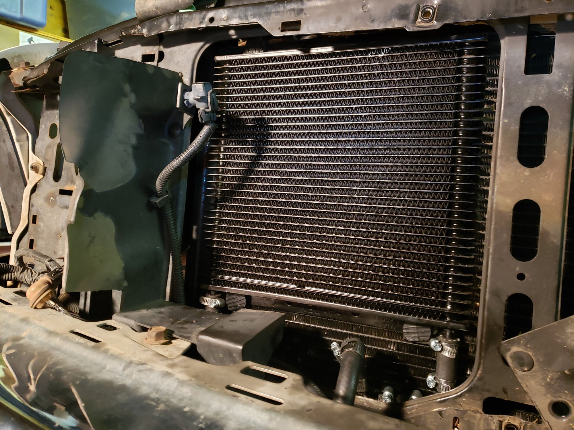

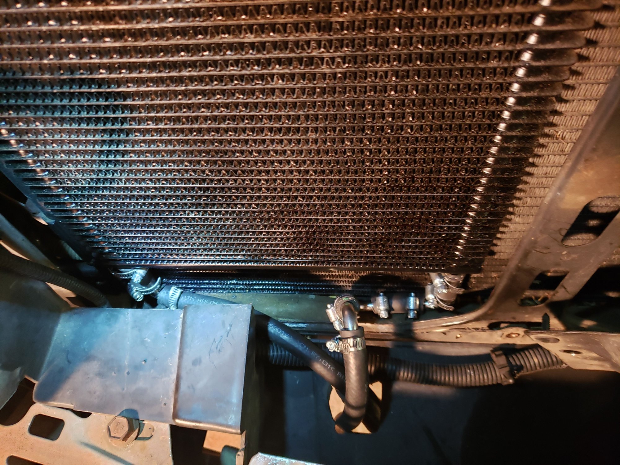

Finished installing a larger supplemental transmission cooler, Hayden 699.
This involved removing the radiator so was a bit of a hassle.
To install it without bending the hoses too tight, I installed several 90 degree elbows. I picked ones that would flow well along a constant radius path.
The 90 degree elbows.
I had to remove the hood latch frame to install it.

Gonna be a cool transmission.
I tow my sailboat that with trailer is 2,200 lbs over some large passes and up some steep grades (e.g., 1,700 ft in 6 miles) so I want to keep my transmission cool. This one has a thermal bypass switch built into it so that the fluid will bypass almost all of the cooler until its temperature is higher.
This is my insurance policy against every having my transmission fail again.

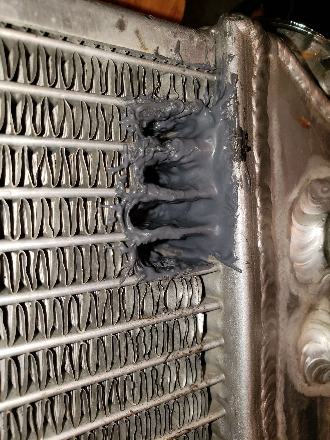

Finally got the Blazer back together after having on the jack stands for almost a month.
This is the list of what I did and tried to do:
  • Installed a new pitman arm
  • Tried to install the 1-ton idler arm
  • Replaced the radiator locating dowel bushings
  • Fixed leaks in radiator with JB Weld. This took a few attempts until I figured out how to locate them using a radiator pressure tester. I also learned that a few drops of acetone can thin the JB Weld just enough to let it flow and conform to the surfaces.
