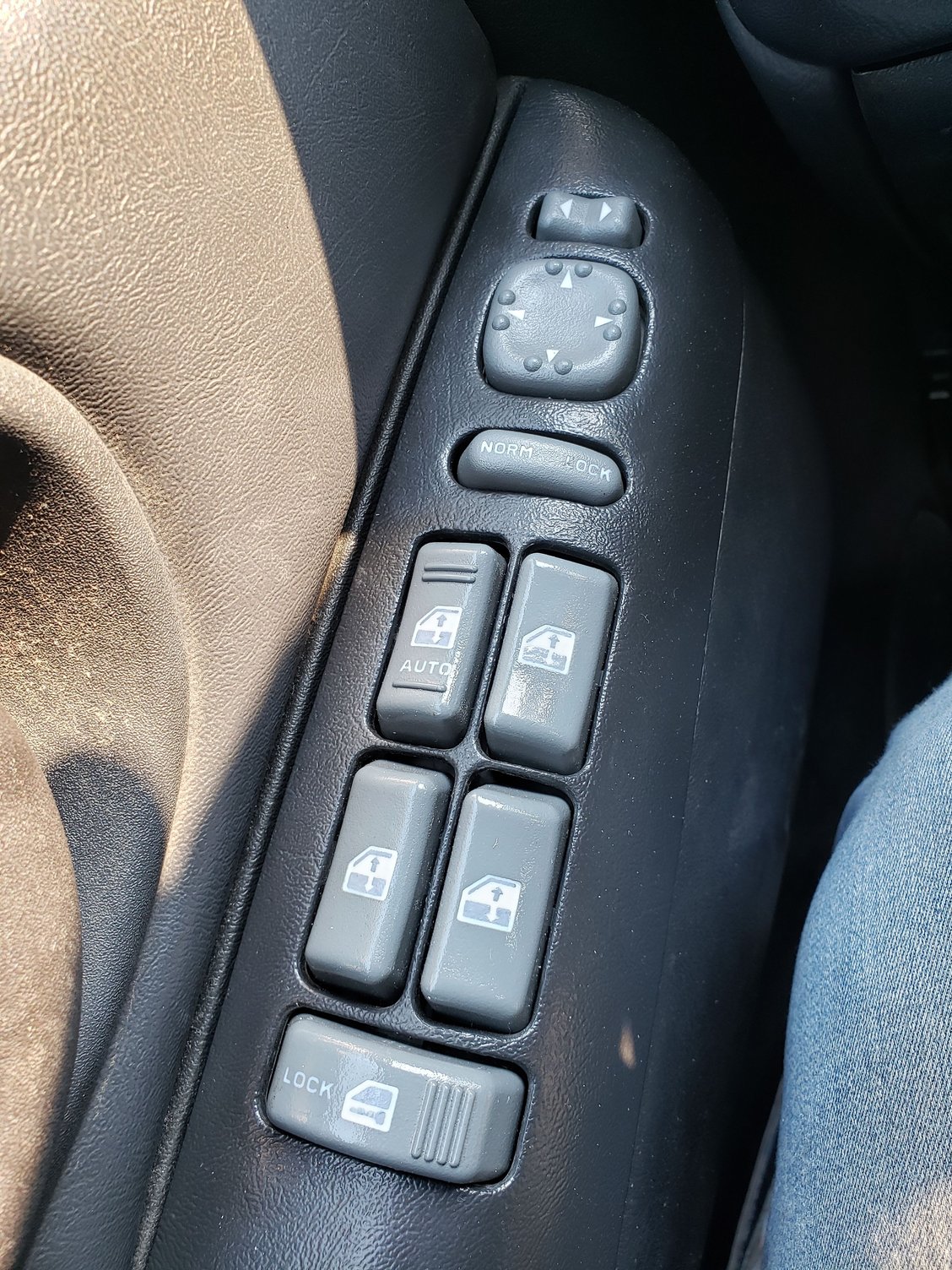

I was replacing the plugs on my window switches due to a random in-op condition of the drivers window when I decided to see if I could repaint the symbols.
It turned out pretty good but I wouldn't suggest any one do this. LOL
I used the gray Testors model paint and sprayed it with testors clear coat. Because my switches were not too worn down I could follow the molded outline of the symbols. I had to use the smallest brush I could find along with a magnifying glass.
Only after I did this did I find replacement switches on eBay that are also illuminated for about $35. (There are $15 ones but they are not illuminsted.)
I still have a spare switch so that is nice.

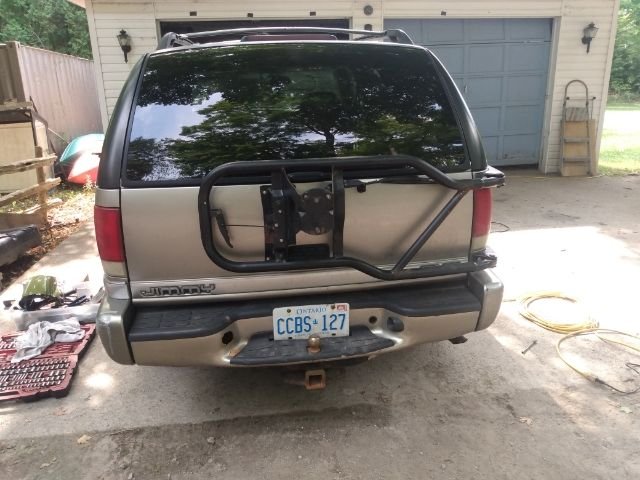

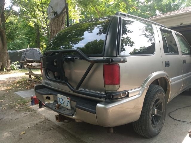

Installed the tire carrier on moms jimmy finally...

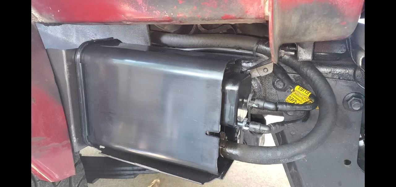

Exclamation Leaf springs, mud flaps, charcoal canister...
Installed new Husky leaf springs and Husky mud flaps. The tie bolts on the new leaf springs were a half inch too short, so they didn't lock the lower plate in place; so I had to go to Advance Auto and get some five inch leaf spring tie bolts and just cut them down after I installed everything.
Removed what rust I cared to remove and sprayed rust reformer over everything, added high-temp paint on the exhaust pipe, added custom flaps in the rear wheel wells to protect the exhaust and frame from water and debris. Then sprayed truck bed liner in the wheel wells and unprotected areas where the tires are. Also new GM Charcoal canister. And happy the canister support tray isn't rusted away. I think I have one of the only original ones left in existence. HAHA XD

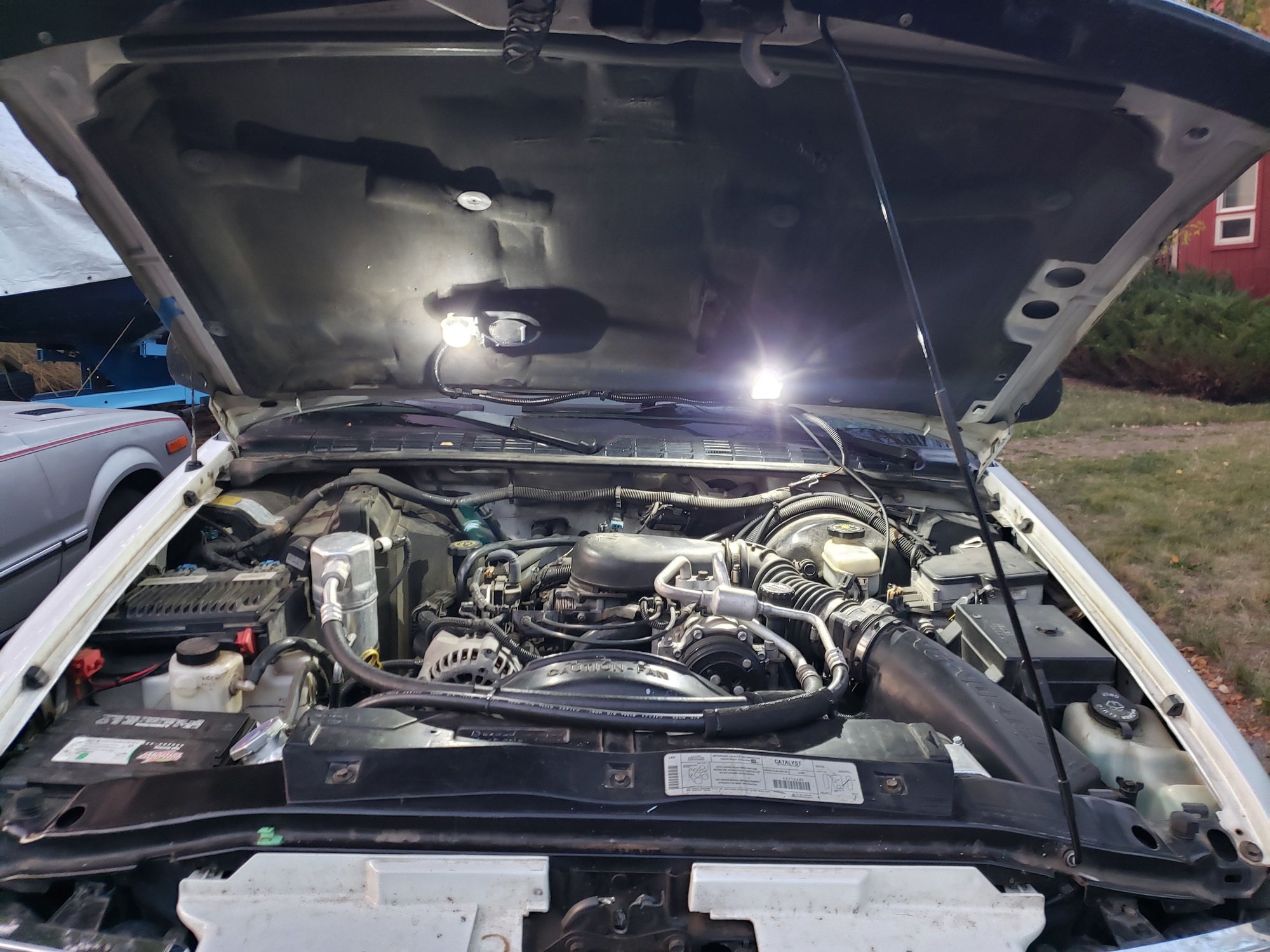

I added an extra under-hood light from a 90's full size truck that has a retractable power cord. I also I upgraded the bulbs to LEDs.
I'll post details at my build thread.
The new light nicely illuminates the other half of the engine compartment.
Close up of the new light. It has its own on/off switch. It has power all the time so it must be manually turned off.
The new light showing the remote lamp option with its magnet to hold it in place.
