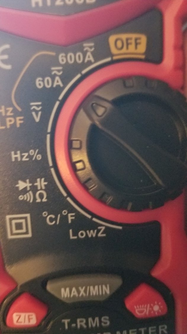

Afternoon George
Here's the meter I bought, hope it's good enough to do what you're talking about...
I'll go do a quick check without pulling fuses. It's cold as hell here right now...lol

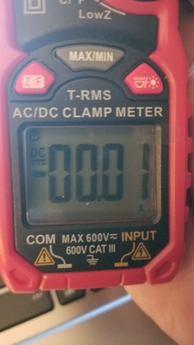

Okay, I just started the truck, cycled everything on and then off. moved the windows, radio, blower motor.....etc.
Then I released the hood, turned off the vehicle and shut the door.
At 10 minutes I clamped around the negative battery cable, I saw as much as .40 on the 60a setting, after 15 minutes I reset zero and clamped the same battery cable and saw
a .14 to .18 fluctuation. I,m assuming that's bad.

It might not be the starter motor. There are relays, switches, wires, connectors. What is the battery voltage at the battery posts when its clicking and not cranking, thats easy enough to check? Let me know if you want to test further and diagnose or if you just want to replace the starter motor and see what you get.
Ya, that parasitic draw is too high 140-180 ma but its not catastrophic and probably not enough to drain the battery in one overnight cycle. When you leave it for the night do you lock it with the remote (activates the security system and more draw) or the door key?

Afternoon George,
I have some good news. Yesterday I replaced the original starter with a new AC/Delco Starter from Rockauto. It was awful but got it done without too much trouble...lol.
Anyway, the engine spins over much better and when I got home today, I cycled everything and opened the hood. I waited 15 minutes and threw the Amp clamp over the negative battery cable. My readings were fluctuating between .04 and .07 . That's good isn't it? I actually suspected and was hoping that a new starter would correct the drain.
