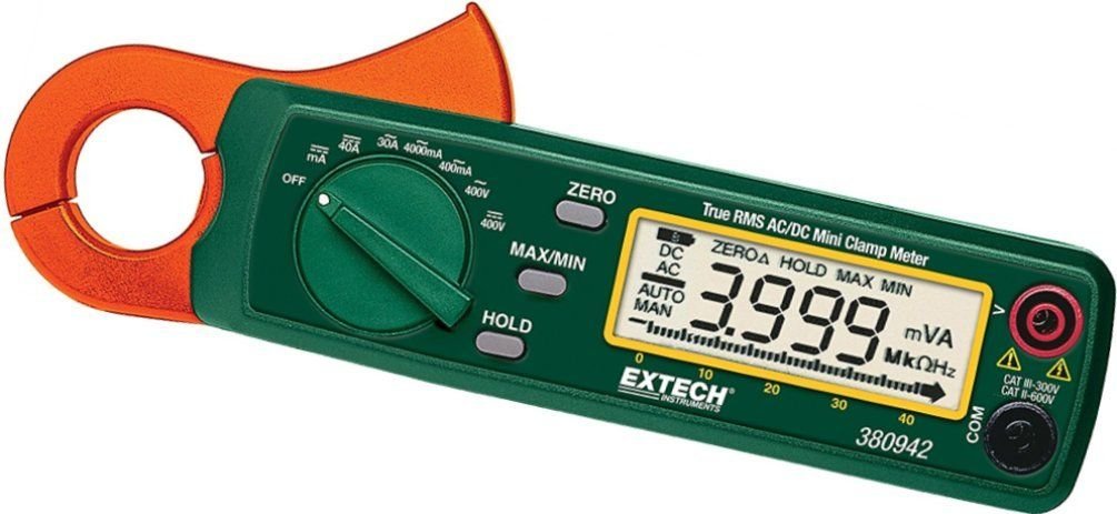

Expensive Clamp meters can do AC volts, AC amps, DC volts, DC amps and/or DC milliamps. Some less expensive meters cannot do DC. What you need is the ability to measure DC milliamps which the cheapest Lowes clamp meter cannot do. A meter that can looks like this (the setting right next to off):

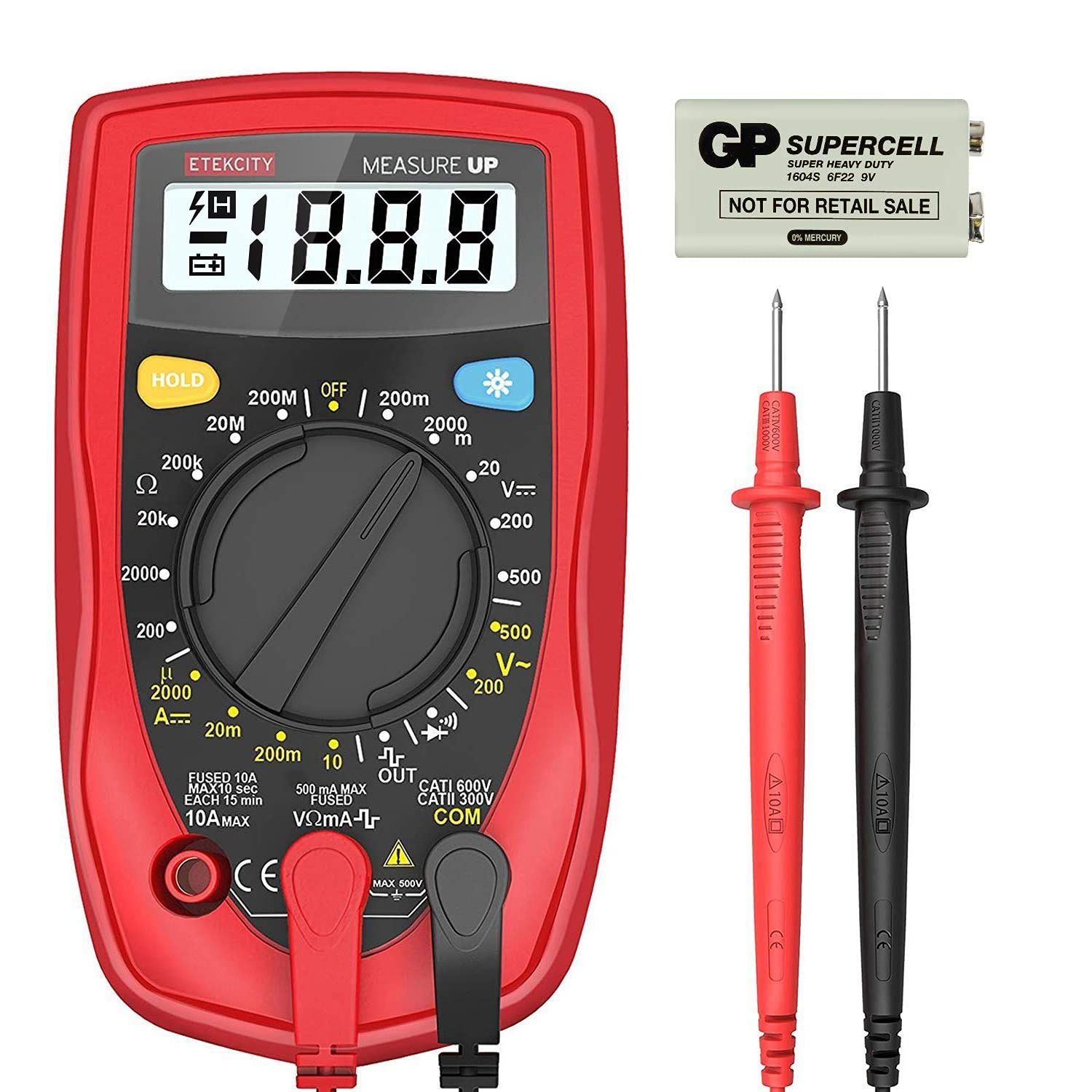

If you do not have this then we need a digital multimeter with 10A DC current (amperage) measuring capability like this (scale at 6 o'clock and 10A protected input on left):
And if you go the second route then we need a way to get the meter probes inline with the battery post and disconnected cable because it needs to stay hooked up during the tests.
