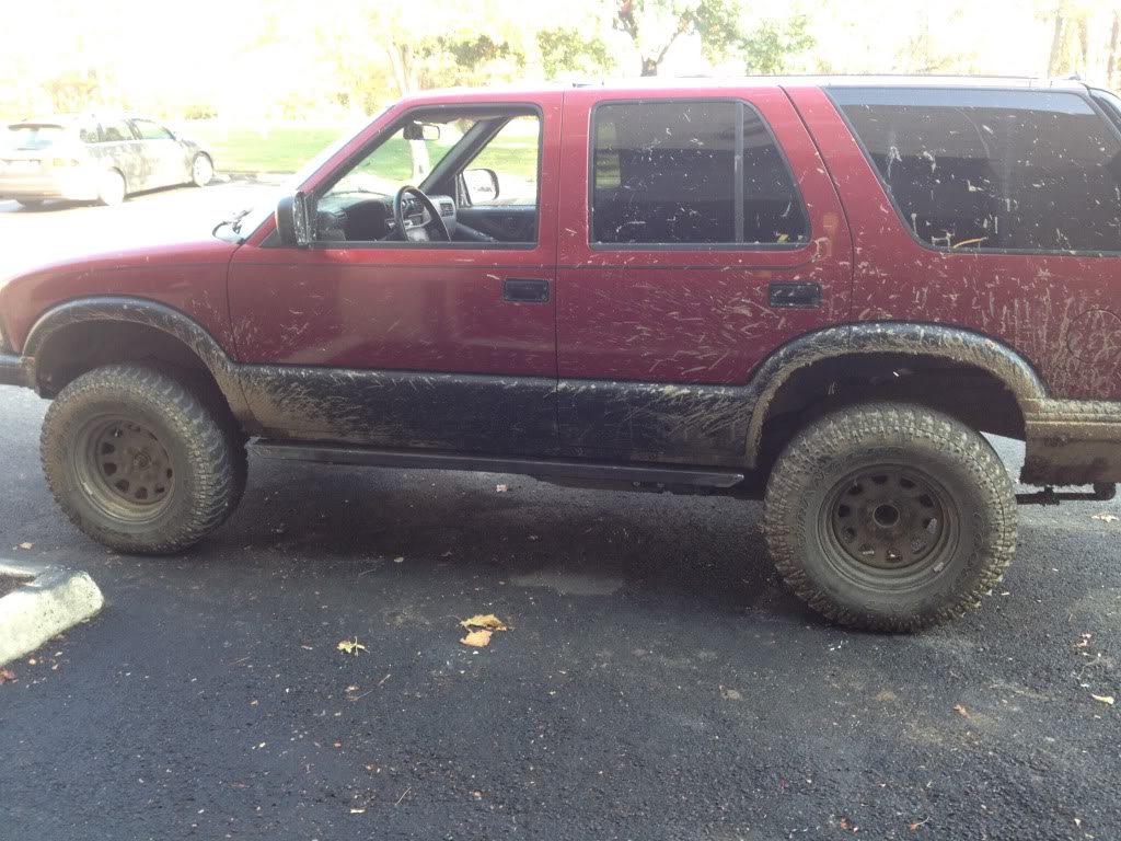

This is 2.5" RC plus 2" BL on 31s I don't think it looks off at all. Even with this combo plus fender trimming I could still get my tires to rub the back of the fenders occasionally so there's no way just a 2" BL would be sufficient unless it was on road use only.
