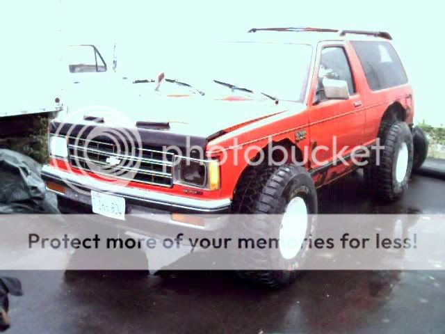

for the price of one sawzall blade and a few hundred wacks with a sledge hammer i was able to fit 35/12.50s on a 85. i later went to 33s to get a bit more power
Hey guys, just wanted to put in some input for lift ideas
