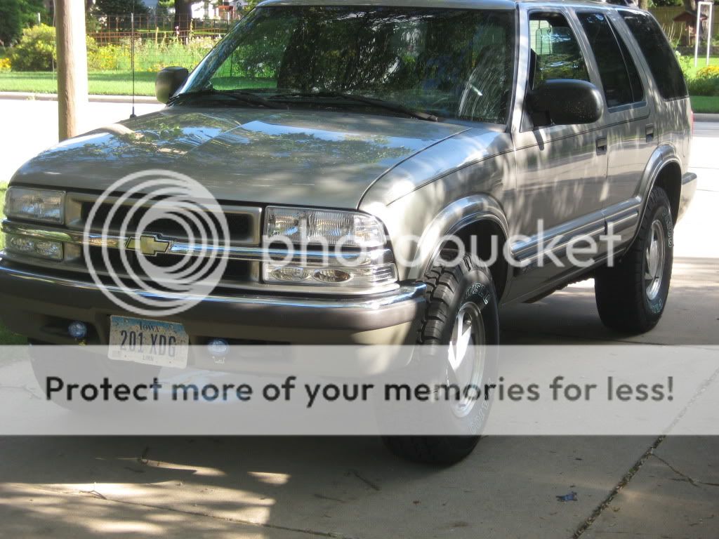

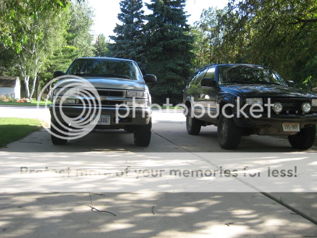

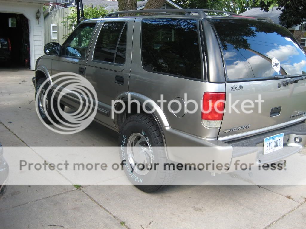

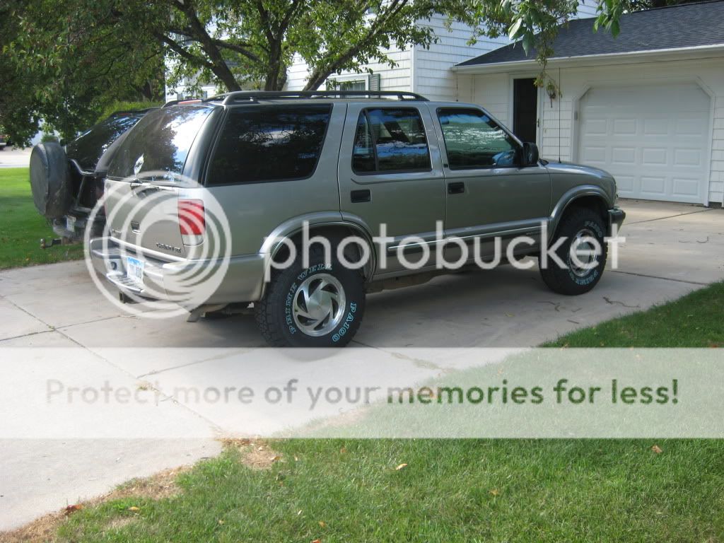

31's mounted, they fit(JUST) no rubbing to speak of.

Thanks for posting the pics. The tires are PA 100's made by Prime Well. They look awesome. They're pretty close to the fender but I think a little trimming will do the trick. Not a lot of road noise, not the traditional howling of MT's. 2" shackles, and about 1.5" tbar crank. Gotta lower the passenger side down a little bit.

I used to have those same exact tires...Looks good.

looks sweet and clean just how i like it.
but really, those are MT's?
but once again, varrrrry nice

I thought the same thing but in person the tires are agressive. Probably half inch of tred.
