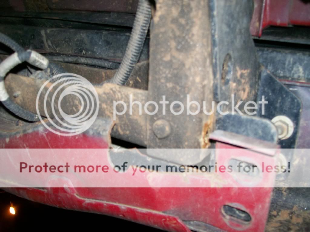

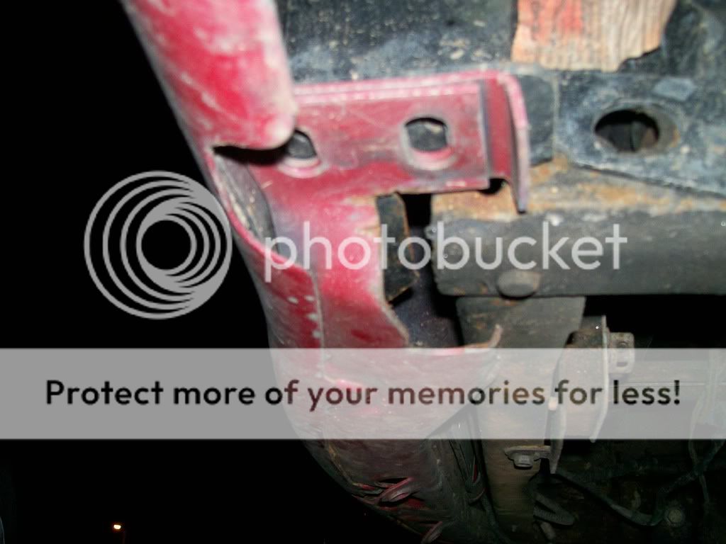

Notches for a 4-door post-body lift bumper re-install:
Notched for frame clearance:
This was my first side...notice how theres alot of extra trimmed off...I got tired of fitting it, pulling it off, trimming another 1/4' off, re-fitting, repeat...so..yea [:-]
Other side, much cleaner cut I think:
This gives you and idea of how much you have to cut in:
Hope this helps

Wolfpack, thank you very much for the pictures! I totally understand where to cut now, and it all makes sense. Hopefully I can kick this flu so I can start working on it again! Or, just take a lot of meds and keep working on it anyways hehe

Thanks WolfPack, I installed the bumper last night. Got my saw out and cut that thing like butter, did my cuts and threw the bumper right on. One disapointing thing is the kit says to install 1 bolt on each side of the rear most spot near the bumper on the new brackets, and they provide the bolts but hey where are the nuts?? I tried fabricating an unused OEM mount but that did not work, well I will just pick up nuts for that.

looks like your missing a few bolts in the bottom there wolfpack
