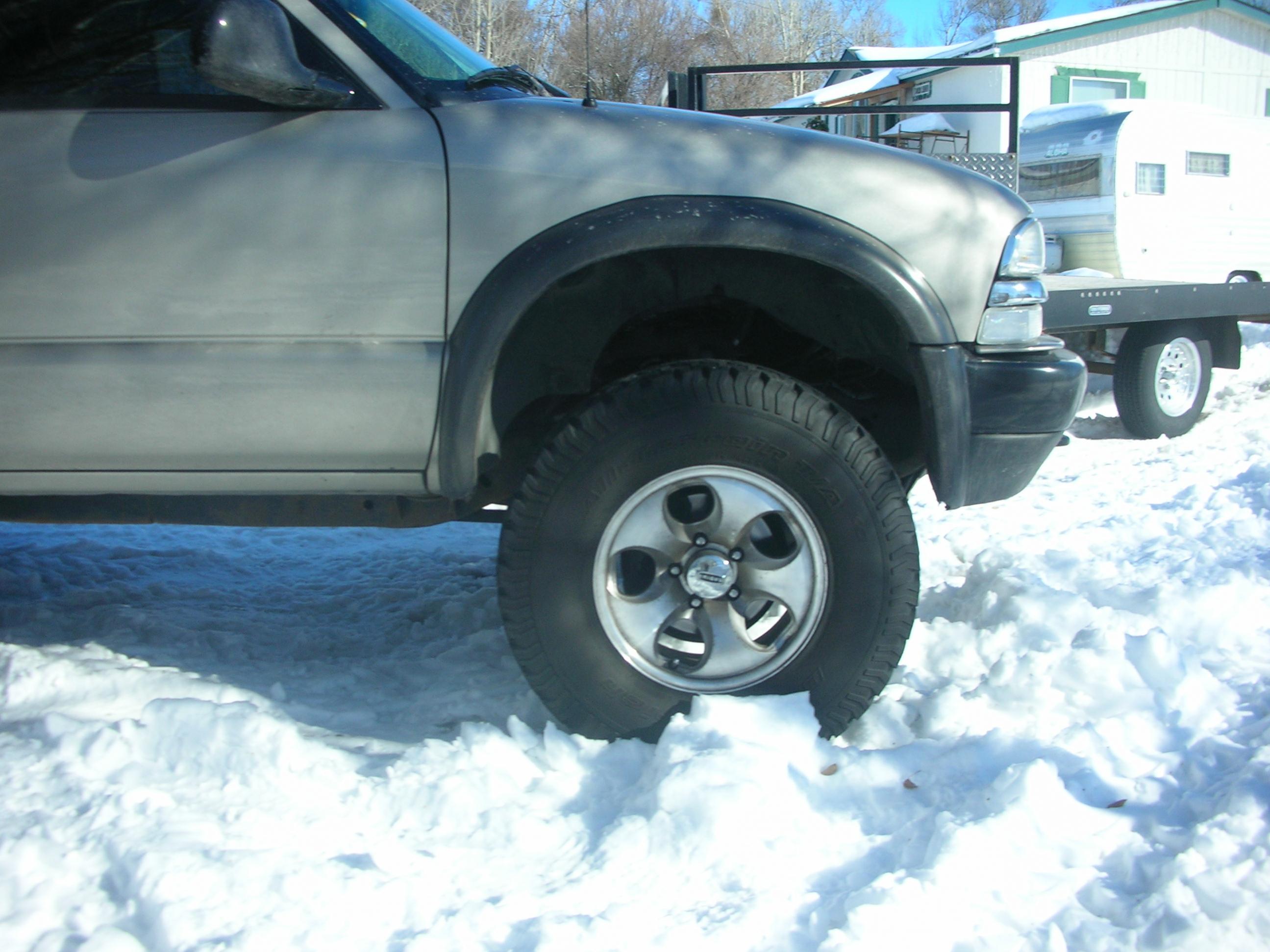

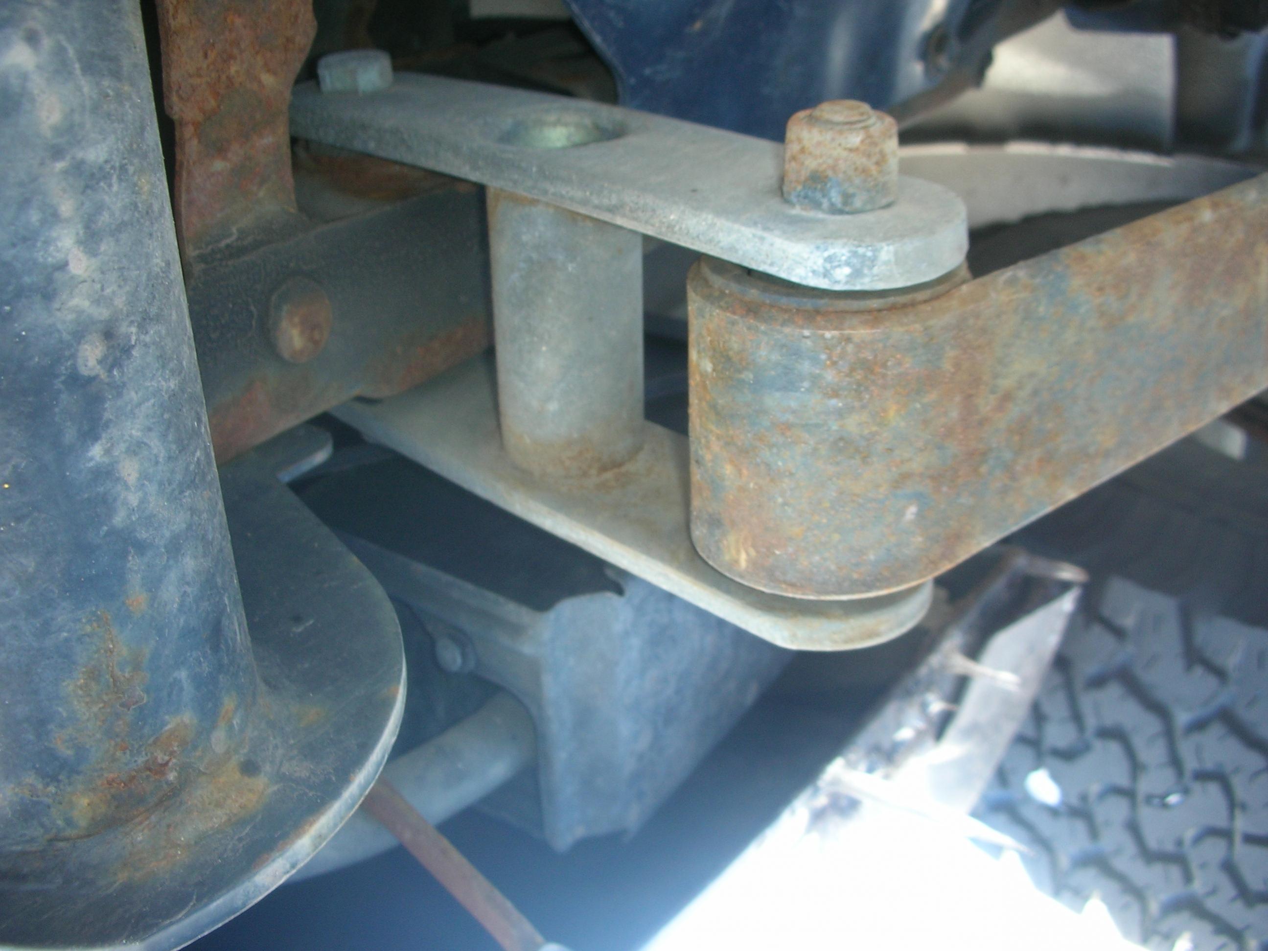

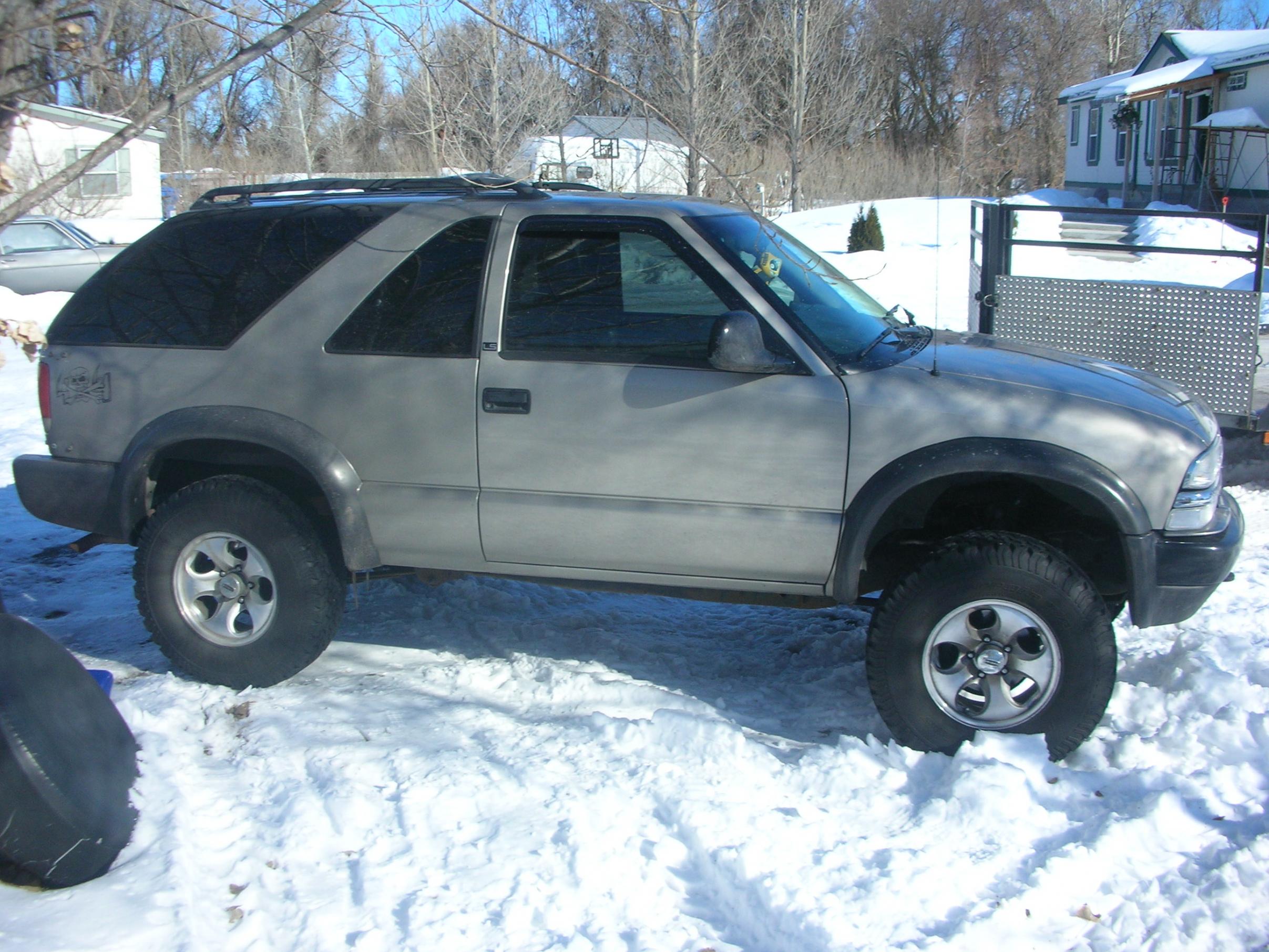

Ok. Mine are really different looking. Mine measure 6 1/2" - 7" bolt hole too bolt hole. And the other one I looked at was also a ZR2. Basically a twin to mine. My tires are the 31x 10.50 on 15x8" wheels. As you can see I tower over them. And their is no body lift on it.

TripleBlackBlazer's Avatar
Joined: Feb 2007
Posts: 3,335
Look like Daystar shackles to me.
Old Feb 1, 2011 | 04:24 PM
Benedict1337's Avatar
Posts: 3,133
From: Harrisburg PA
stock shackles are 4" long
