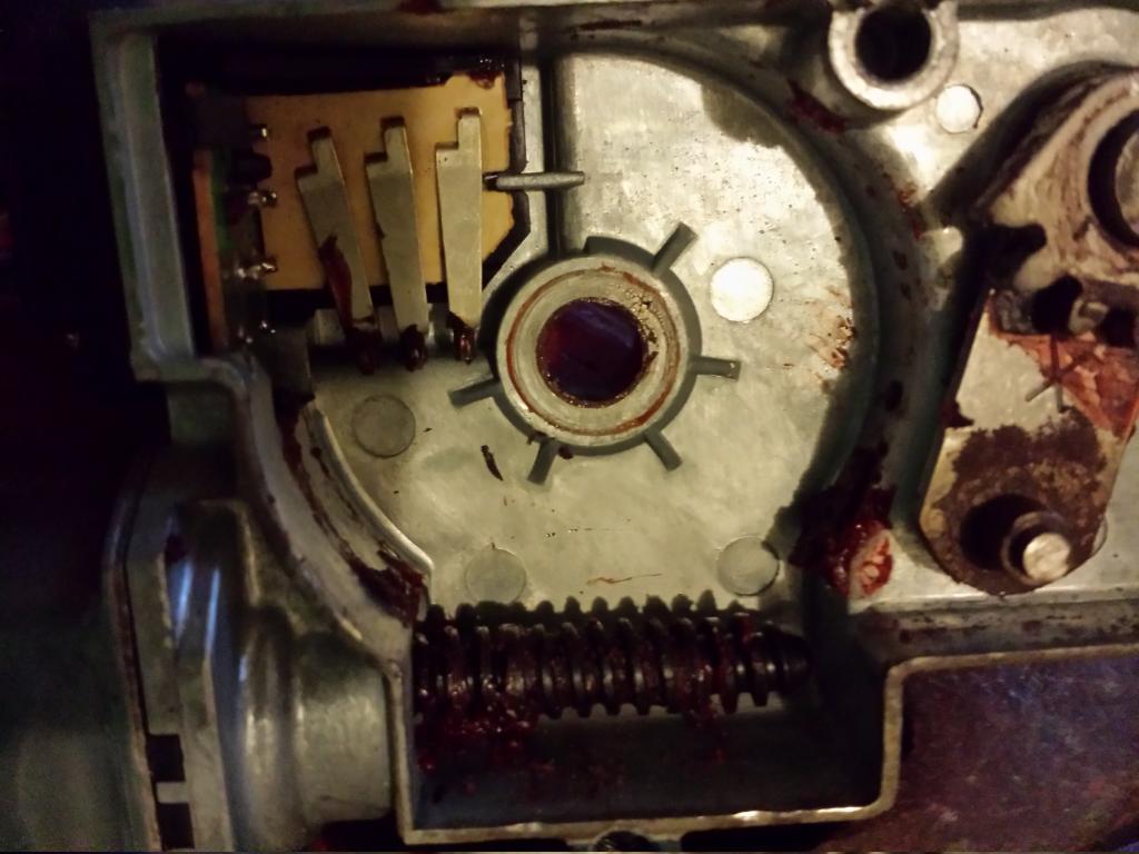

once you have the black plastic cover off.
you more or less see this-

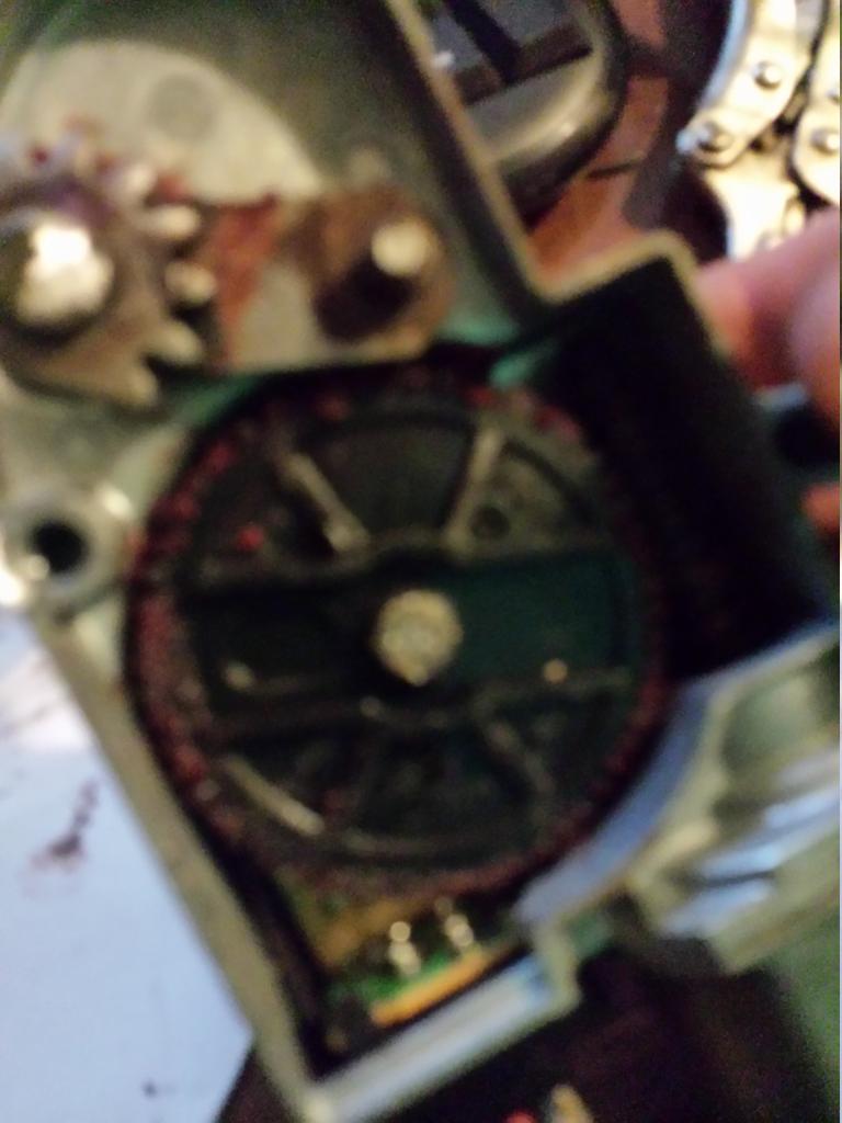

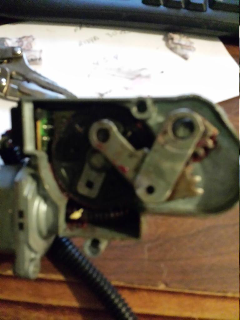

I ground off the head to remove the top bracket.
Once you have that top bracket off, then with some wiggle it will come off, then you see the plastic gear.

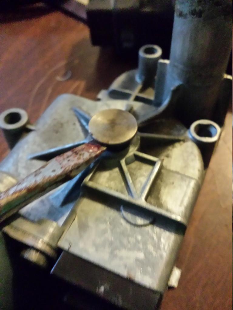

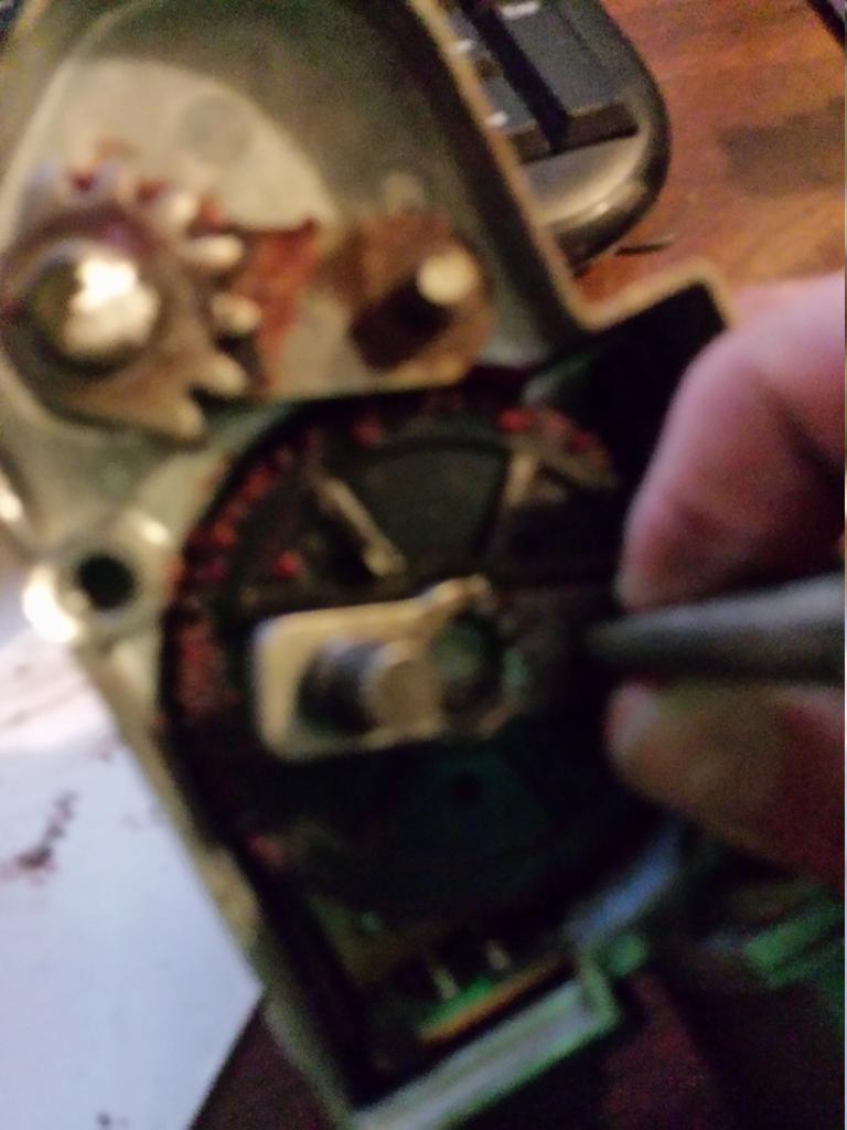

you have to get behind the round black pressure washer to pry it off to remove the plastic gear.
now you have to remove the rest of the gear to fully remove the plastic gear. comes off with some tweaking and light prying.
Now, you just have the gear. the pin thru the back on the other side, you can tap out. to get the gear out.
