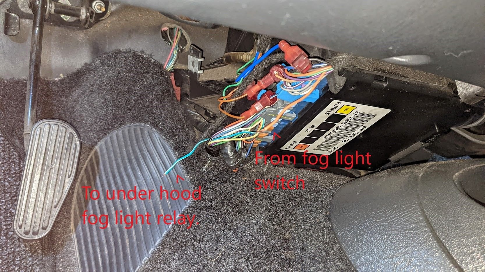

So if you want to do this you will have to cut two wires out of the BCM plugs. The first one is the orange wire that runs from the fog lights switch it's located in the purple plug C3 pin B5 this wire is a negative momentary trigger that will hook to the left pin on the self latching module (see picture). The second wire is located in the Lt blue connector C2 pin A7 dark green with white stripe. This wire is a negative trigger that turns on the under hood fuse box relay for the fog light. The underhood relays only powered when the parking lights are headlights are on. A simple way to test is to unplug all connectors from BCM and use a regular test light ground one in and probe the dark green with white stripe in connector to C2 A7 . The little yellow light in the OEM box switch should light up showing that the relay is on.

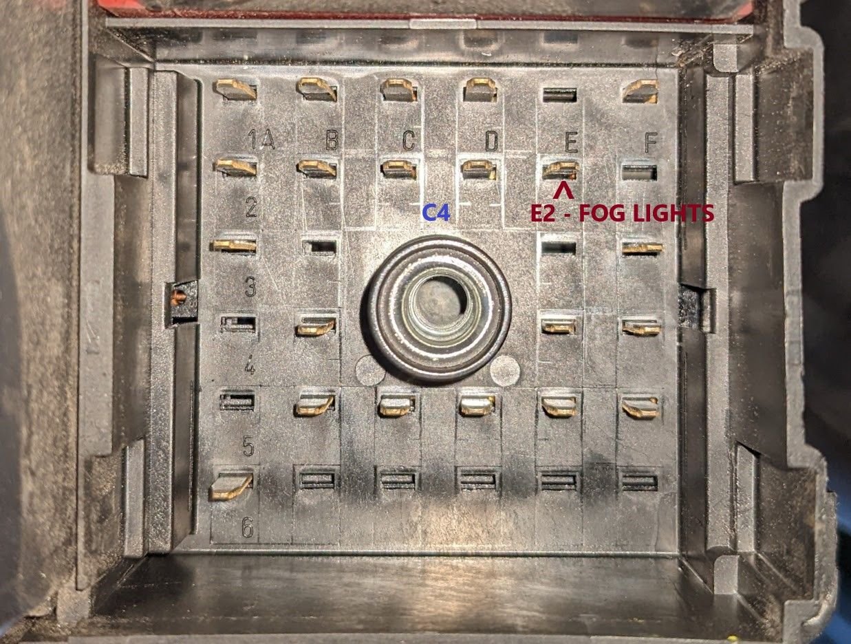

On the self latching module connect DC+ to light blue connector C2 pin B6 Brown that is the parking light wire. Then connect DC - & COM two brown connector C1 pen A1 black wire (ground). Now connect N.O (normally open) to dark green with white stripes on the light blue connector C2 pin a7. The self latching module will simulate what the BCM would do if it was programmed. Nice thing about this module the fog lights will still work when you go to high beam. For pins A1 in connector C1 ground wire you can use a t-tap to connect and for pin B6 in C2 connector also use t-tap. This self latching module has very low current draw so t-tap will work fine or you can splice and solder that's up to you. The self latching module will be only powered if the parking lights or headlights when they are on so no parasitic draw when parking lights or headlights are off. Now for the under hood connection that is C4 connector headlight harness pin E2 is the fog light out. It is easy to add a wire to this connector just go to your local wrecking yard and pick one out of a connector or you can pick up a complete headlight harness with fog lights for about 10 to $15 at most you pull a part. Just make sure the fog light wires in the right location E2 some years may vary.

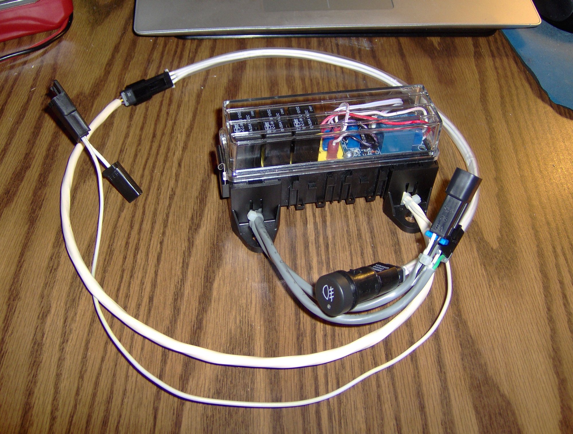

I've been working on a circuit to allow a full bypass of the daytime running lights (DRL) system. My Blazer was delivered to Canada so that the DRL system cannot be disabled.
I've not tested it yet but I was attacking it much like you have. I even used a latching relay system too. Although I like how your system is so simple. Mine is much more involved as you can see. I use relays to disconnect the DRL circuit from the external light switches. I added a push button switch to the standard headlight switch to toggle between the manual and DRL system. I'd be happy to share my circuit diagram if you like.
