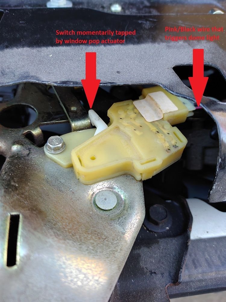

Now, there is a switch called the "rear wiper cut out switch", part number 15068307, that gets momentarily bumped by the glass actuator when the button is pressed to open the back glass.
I took the switch apart and found the contacts were burnt, so I cleaned them all up and used a meter to make sure the switch was working correctly, based on it's internal design, afterwards.
The switch has 4 wires going to it, Black is ground, and pink/black is a negative trigger for the dome lights, the other two wires are gray and white, and I believe those have to do with the rear wiper cut off feature.
From looking at the internals of the switch, when it's bumped to a certain position, it's designed to short black and pink/black to turn on the dome lights.
When I press the button to pop the back glass, the actuator bumps the switch momentarily, which in turn shorts black to pink/black and momentarily flashes the dome lights as I expected based on the internals of the switch.

Turns out that switch inside the latch does control the dome light, and even though mine seemed okay on the inside, it wasn't working.
Grabbed a few from a scrap yard, works like a charm now.
