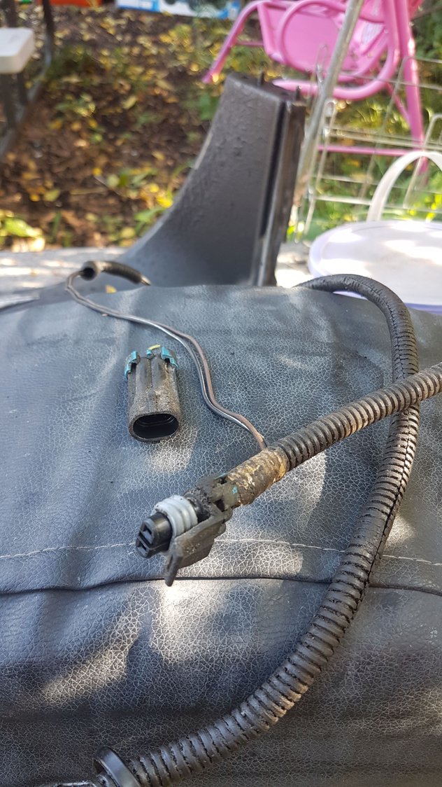

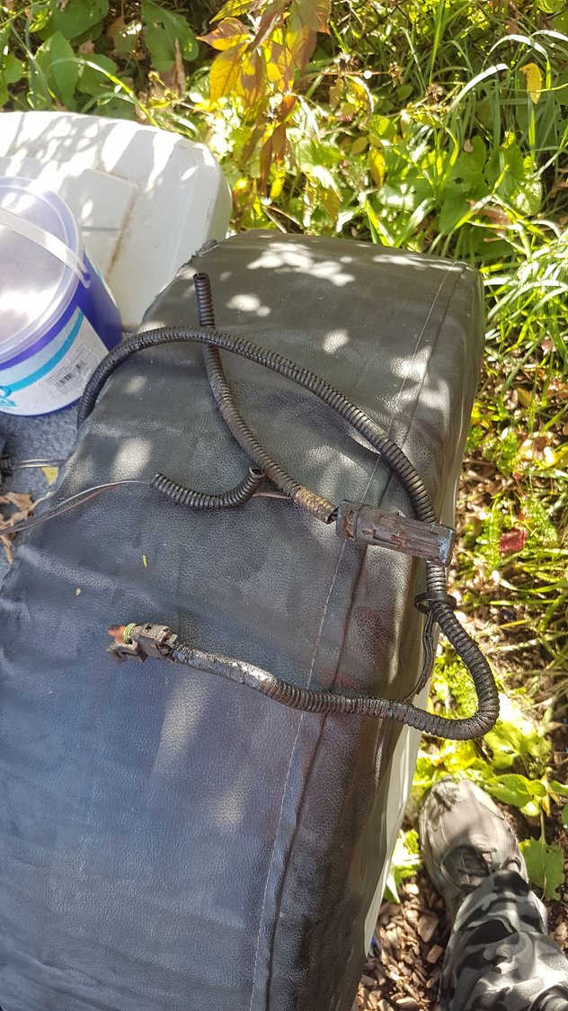

While changing the water pump, I decided to take a visual at my 4x4 as its inoperable. I found that it wasnt connected to the fron diff, but as I traced it back, found it wrapped around my steering column, and ripped off connector end sitting on my frame.
I know the end that goes to the diff, but I'm unsure on where to start looking for the missing wires that were ripped out of the connector.
any idea?
Wire to front diff(orange end) with ripped off end

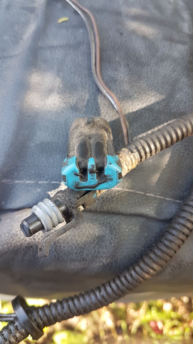

Ripped off end with the male connector that wires to the diff
it looks like the wires where ripped right out of the connector cleanly at some point.

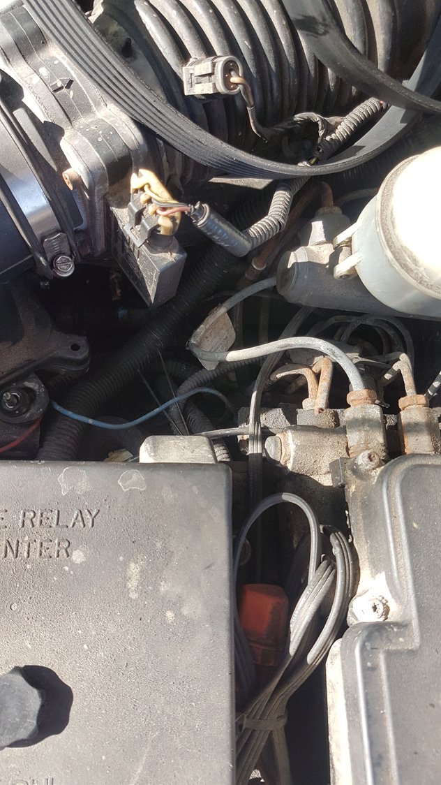

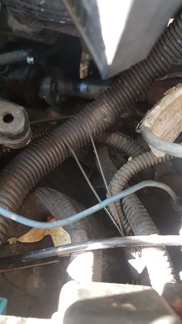

Never mind. Upon searching the area a little harder, I have found the wires.
now to get everything back together and working...

I pulled apart the plug, you can pull off the blue plastic piece front the end of the female connector. There 2 blue "water seals", one for each wire. They can be pulled out easily.
I re-cut the end of the wires, put the "water seals" on the wires, and put the female connector back together.
once I properly fed the wire away from any moving parts, I connected the ends and tested the buttons to full success.
