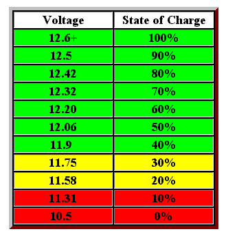

Your battery voltage is way too low. Step one is getting a charger on the battery, turn on the headlights for 15 sec to knock off the surface charge and retest. A fully charged battery is 12.6v. Yours is too low for the truck to operate:
Once we get that done we can continue getting you back on the road.

Sorry. I uploaded the wrong chart. I edited the last post.
