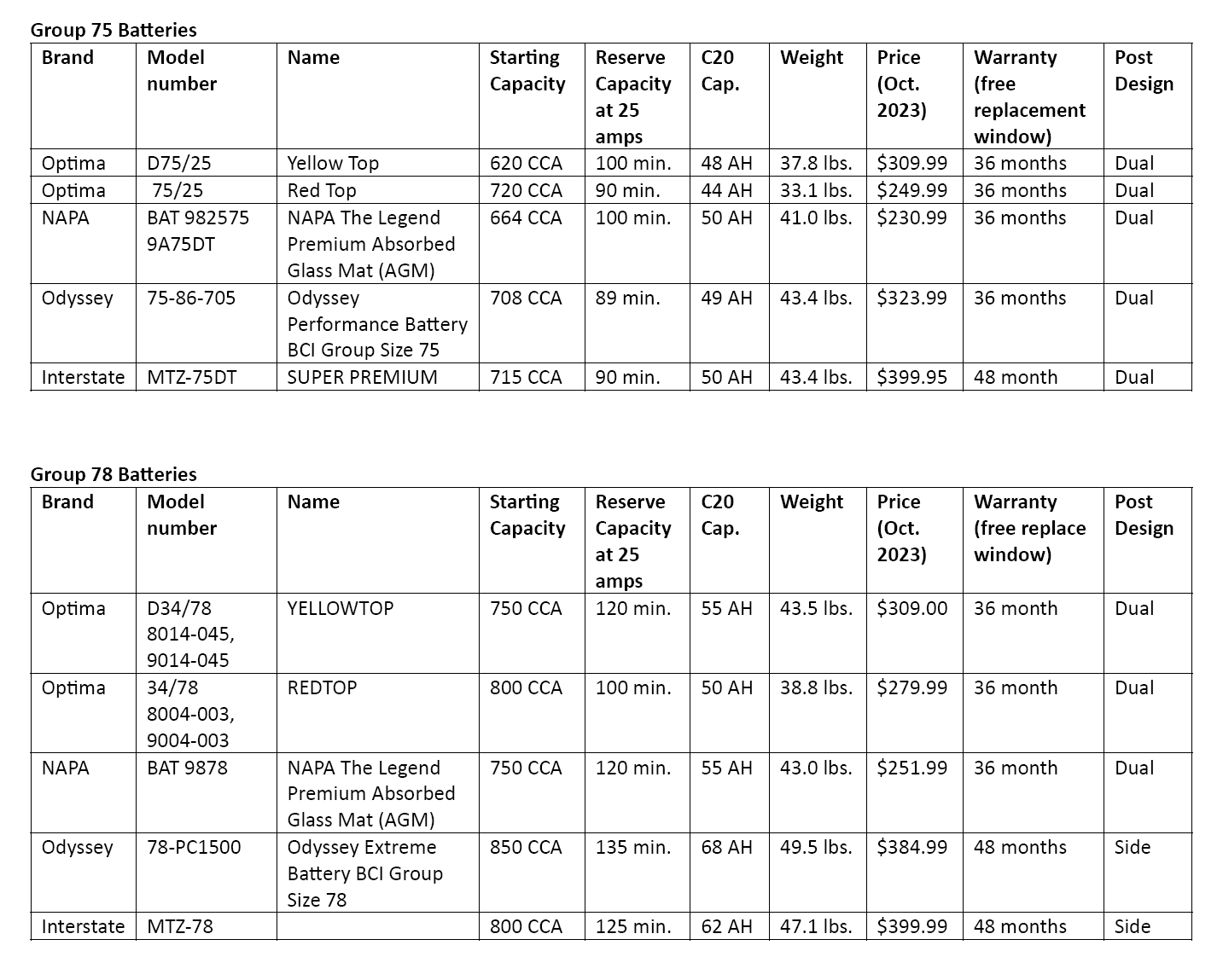

In case anyone comes across this, here are the options for AGM batteries I found in Oct. 2023.
The stock size for my 99 was a group 75. However the slightly larger group 78 batteries can fit although some modification of the battery tray to cut off the rounded corners may be necessary. I If using a group 78, the original battery hold-down mechanism might not be usable. An over the top type will likely be needed with some modification of the battery traying being necessary.
