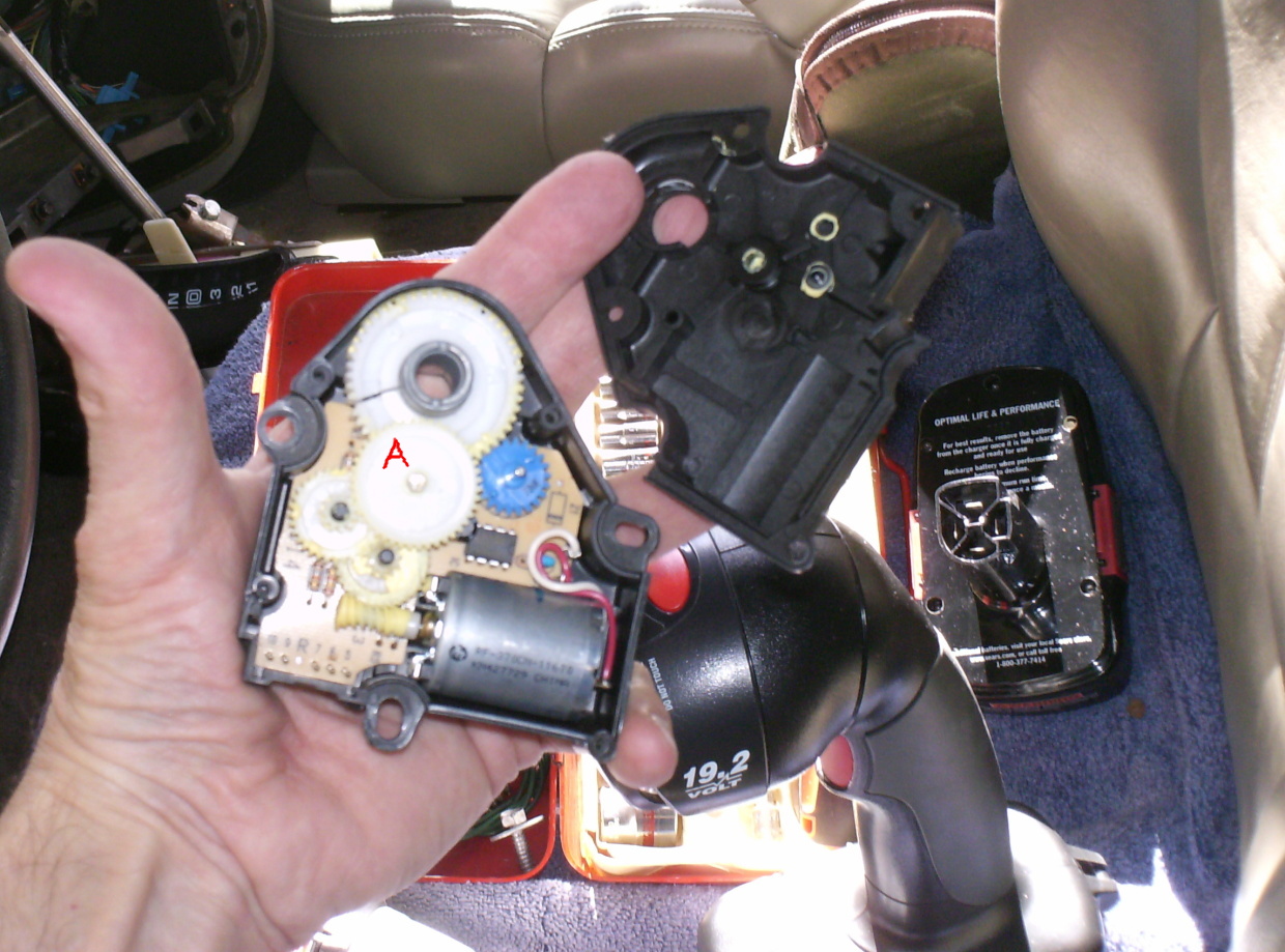

Then off to Advance / Zone, and after uploading $167.xx ouch yikes, I came home with the new one. But before plug n pray put in the new one, I'm scopin' the old one here... , let's see what we can do with the old one.

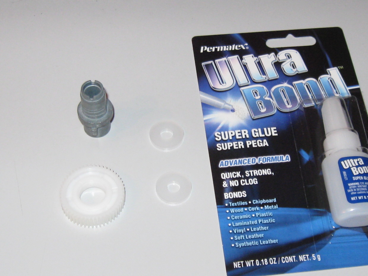

So I went fishin' into the jars of nuts and bolts, and found a couple of nylon washers. They need drilling, to match the size of the shaft.

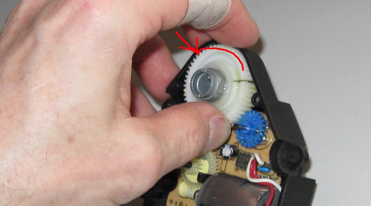

Then, it looks MAYBE like the big gear does not actually do a 360, like the smaller gears do. Looks like less than half a turn more like. So, pull the gear, CLEAN it, and the shaft well, and spin it 180' on the shaft. Then the cracked spot is away from meshing with the other gear.
Then, give the gear re-inforcement, with a nylon washer on each side, and superglue each one.
Allow to dry, re-install, and take a deep breath...
Post back on it tomorrow here.

The cracked spot in the gear is still 'open' with the fix. To try to close the gap, and fix it that way would have been futile, because even with the crack 'opened', it fits tightly on the shaft. It would break open as soon as I tried to re-install the gear on the shaft (or break in another spot - WORSE). Gear slippage is not the problem anyway, I don't believe; rather the other gear hitting the 'open' spot in the cogs.
So since the cracked gear does not move 360', but less than 180', the 'fix' MIGHT work by spinning the gear halfway around on the shaft. For $167, you bet there's some room for ghetto-engineering .
After installing the gears, make sure that the cracked spot does not rotate to mesh with the other smaller gear (the BLUE gear). To do this, leave out the gear noted in the pic as 'A' gear. This is the 'BEFORE' pic - that's why the crack appears in the same spot).
Then rotate the shaft, and note position. Depending on where the crack is on your gear, moving the gear less or more than180' on the shaft will be proper). In my case, the crack's position AFTER movement ended just before contact with the blue gear, from about 11:00 position, to about 3:30 position. Note that this is the actual range of the shaft, and of the duct door in the temperature control function.

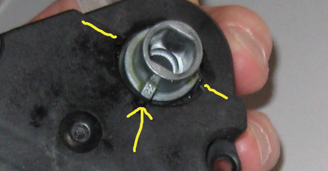

To determine the correct position of the re-installed FIXED gear:
1) Rotate the shaft until the stop-block is in the middle of its' range pic 1
2) place the gear onto the shaft, with the gap at 180' to the blue gear:
