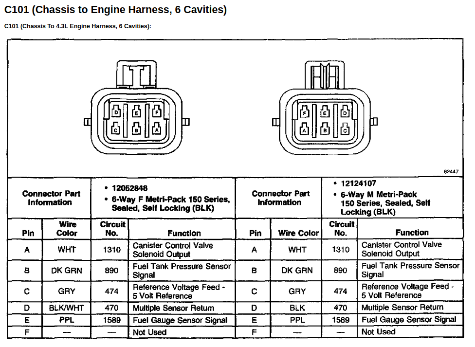

I had to cut out and replace a section of the harness that runs to and around the trans, and I have 5 wires for this connector that I need to pin out.
It's right by the B1S1 O2 connector.
Truck is a 2000 4wd Jimmy.

Found it.

Thanks. Few more wires to figure out now, and I'll be ready to tidy everything up, and attempt the 1st start in 10 months.
