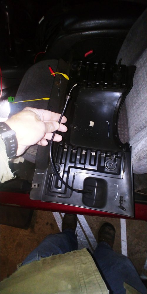

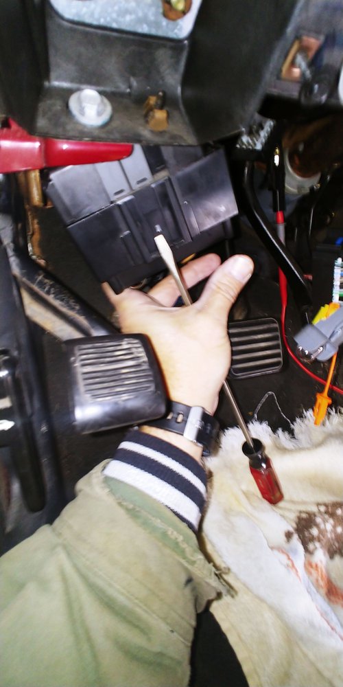

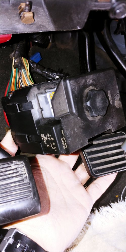

Picture time for anyone curious about the BBEC. NOTE: Before accessing disconnect your battery.
This is the BBEC after being dropped from it's retainer:
This is with the cover removed. Note the circuit breaker with the green paint on it is the Power Window Breaker for my '98 2-door ZR2. Check diagrams for your specific truck:
The screwdriver is pointing at the retainer that holds the BBEC in place. You'll have to be a bit of a contortionist to see it in its position. After you have removed the knee bolster and with use of a flashlight you'll see it. Not really easy the first time you do it. When you look up there you'll see two black hooks that you'll swear you have to disengage. Trust me, don't waste time trying to pry those out of place. In between those black hooks you'll eventually see a slot you can insert a screwdriver. With one hand giving the screwdriver a bit of a twist, use your other hand to lower the BBEC. It might require a bit of wiggling and up and down movement but the BBEC will easily come down. Just be gentle with the screwdriver because if you break the tab that retains where the screwdriver is inserted, you may end making a trip to the salvage yard. When you do it the first time you'll be surprised how easily you can unlock the BBEC from its position:

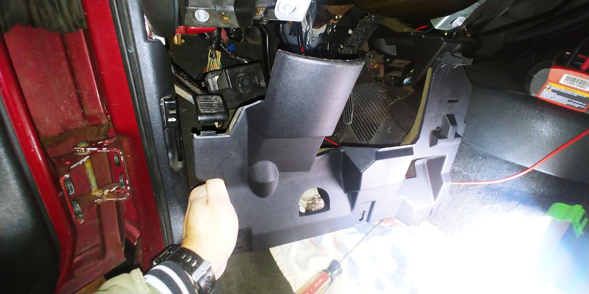

The next three pics show the panels you have to remove. When you remove the knee bolster you'll have to disengage the parking brake handle cable from the park brake pedal assembly. Just pay very close note how the cable is routed thru the wires. Don't just yank it out so the metal end snags on one of the smaller wires and damages it. Any questions, let me know:
Below pic shows hole where park brake routes through:
