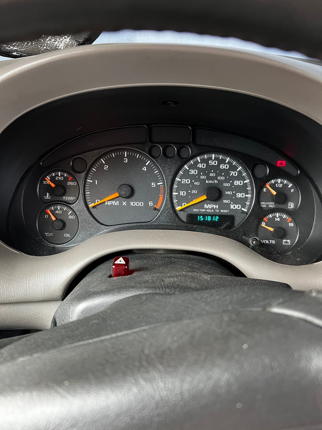

Here’s a picture of the dash with the key turned that’s all I get and it will crank but won’t start.

the gauges going crazy sounds like a bad chassis/ dash ground.
A bad ignition switch can do strange things on an old vehicle.
Also look at the bulkhead connector on the firewall...is it loose or melted? Fuse block have any overhrated connections?
